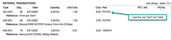

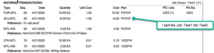

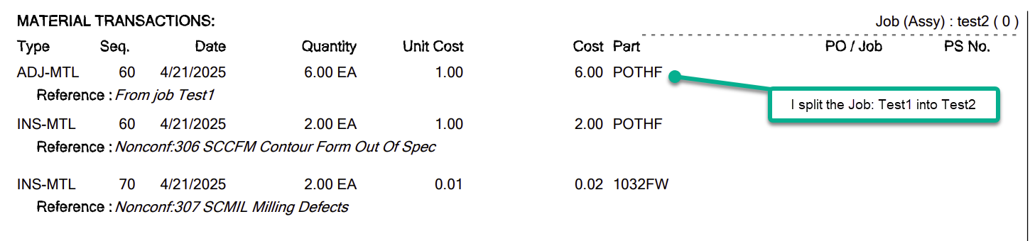

Here’s the two transactions
Job: Test1
Moved material to Job: Test2
