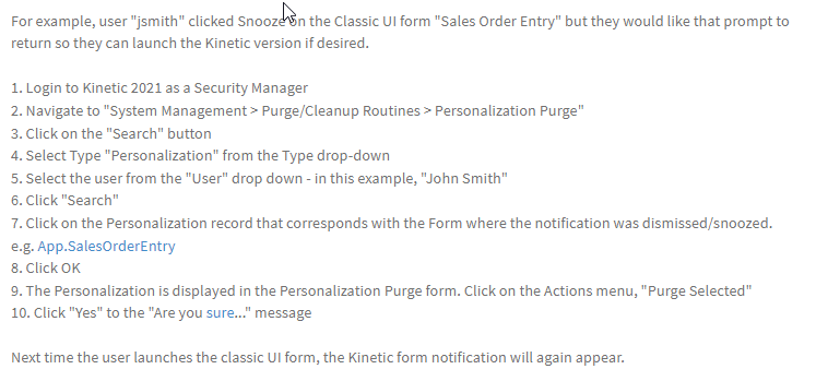

This is saved as a personalization, not sure if you can unsooze it from the UI, but it is saved on Ice.XXXDef
Mr. Jonathan: Thank you - that was it.
I deleted the Personalization and I now get the Banner asking about Kinetic.
Thanks again,
DaveO

If you are trying to remove your own personalization from a classic screen, you can just do reset layouts to base in the tools menu on the specific screen, or use the personalization purge program. There isn’t any way to remove an entire personalization in kinetic, although there should be.
This does not work, or at least it did not work for me and a few of my users.
What did work was following the steps in this EpicCare Knowledge Base article: KB0114121

This removes all of the User’s Personalizations on that screen, not just the SNOOZE function.
