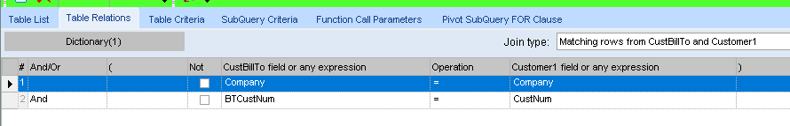

The Relationship to the second Customer table (Customer1) is different that the first

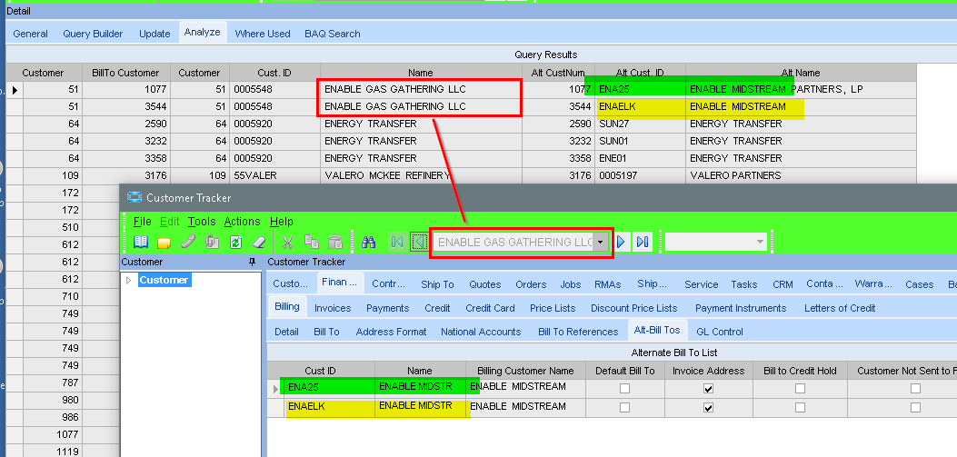

The following is the output of the BAQ with the Customer tracker laid on top to show the realtionships.
CustNum 51 (ID: 0005548) has two Alt Bill To’s: CustNum 1077 (ID: ENA25) and CustNum 3544 (ID: ENAELK)
if you add a table criteria on Customer1.CustID, it would only show those Customers that have that ID and are the Alt BillTo for another customer.
In the CustBillTo table are a CustNum field (the customer that the record is related to) and a BTCustNum field (the customer that is the alternate billto).
