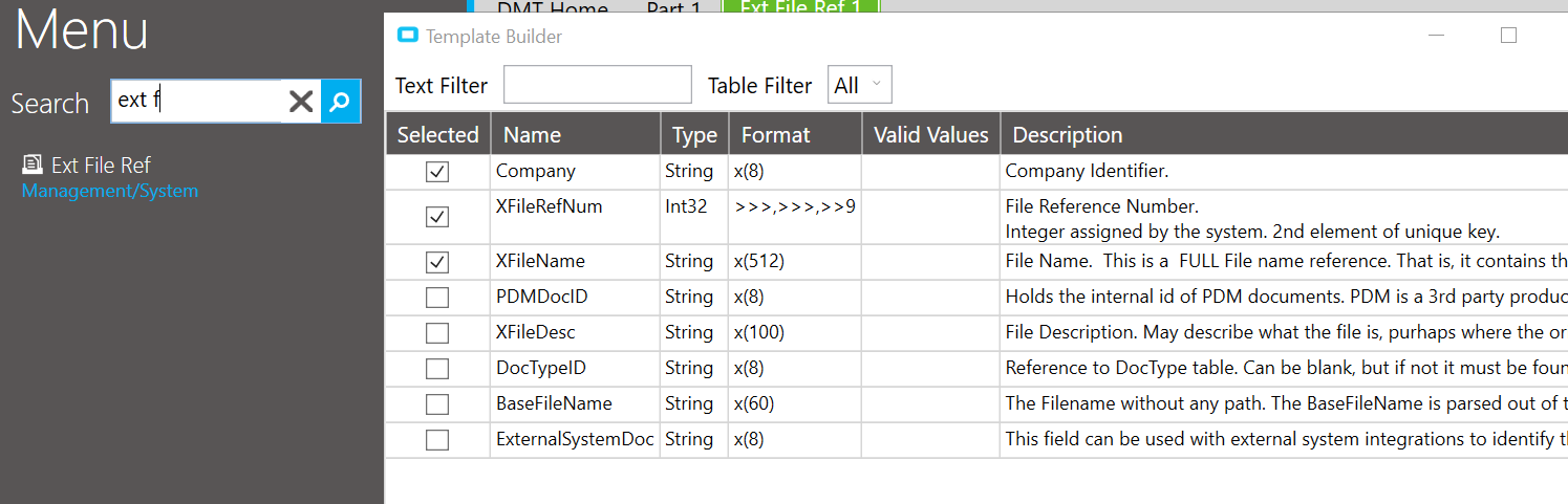

Epicor attachments are done in two steps:
  1. Identify the document
  2. Link the document
The first you DMT with Ext File Ref
The second you choose the object you want to attach to
As with any DMT, do it by hand and check out what fields are used and how. But that’s it. Where things get interesting depends on where the actual document is… That’s why I like Jose’s solution over using DMT.

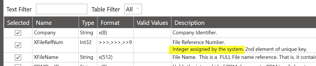

@Mark_Wonsil - When using DMT to make add new records that are typically automatically numbered (Quotes, Orders, etc…), should the DMT file always specify 0 in that field?
For example, your first screen shot shows:
Should the DMT file have zeros in column XFileRefNum ?
If you do create your own numbers are they just ignored?
This can be REALLY important when doing a two step DMT like you mentioned. Specifically because the second DMT needs the XFileRefNum that the system ended up using - which might not match the numbers your 2nd DMT file is using.
So you really need to export the results of the first DMT, to make sure your XfileRefNums in the second DMT file match.
