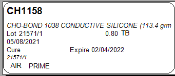

I use a label like this
you can create it easy in a BAQ/BAQR and then use REPORT Builder
the cure and expire come from the lot number info
as long as your BAQ has all the fields you can reort on them how you want
depends how much info you need on a label.
you can easyly do a BAQ/BAQR listing any stock past its expire date
