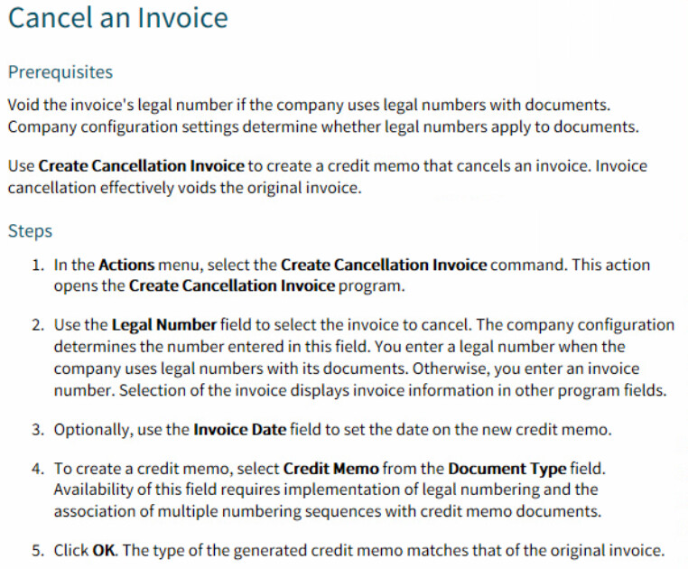

Which version of 10? 10.2.600+ I believe they had cancellation invoice for both AP and AR starting then.
cancel was in by 10.2.400 and the quickest way if you have it.

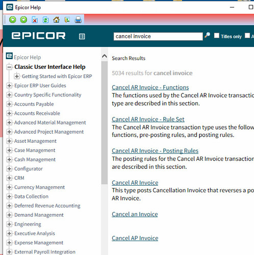

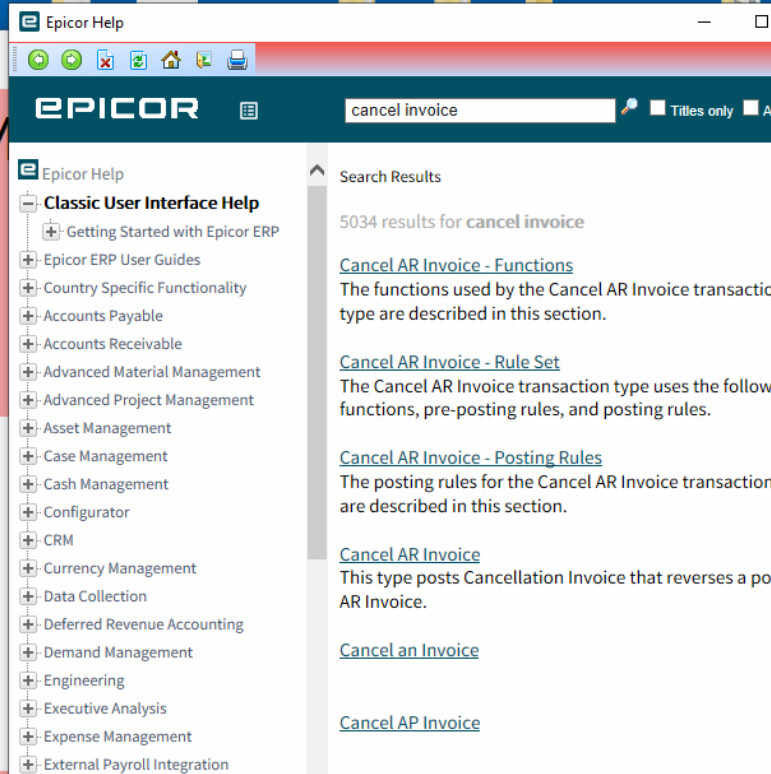

I am not seeing “Cancel Invoice” as an option. I see where I can apply a credit memo, but can’t seem to figure out how to create a credit memo.
If you search in help - Press F1 to open this. Do you get entries like below?
