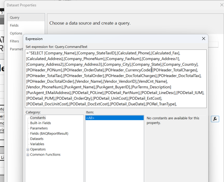

in the query, remove the Terms_Description (next to POheader_CurrencyCode). This might be the issue, because you BAQ now does not have such a column because you changed it.
Good catch, didn’t see it in the screenshot!

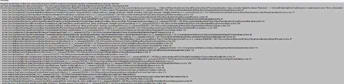

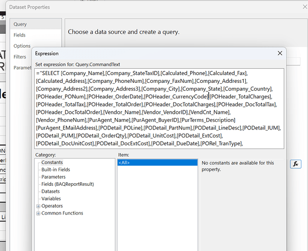

I removed Terms_Description and re-uploaded, but I still get the same error.

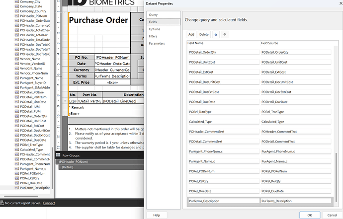

can please take a screenshot of your ‘field’ PurTerms_Description? And just to double check; another screenshot of your error now?
Also looks like you are missing a comma after PurTerms_Description in your query.

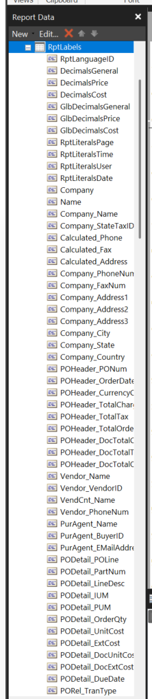

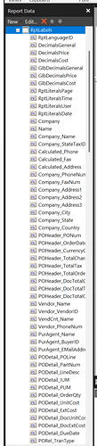

I can see now the error is slightly different. You just have to squint just a little :slight_smile: before it was for the dataset ‘BAQreportResult’ and now here it is for dataset ‘RptLabels’. So, I would check that dataset and remove any reference to column Terms_Description from it.

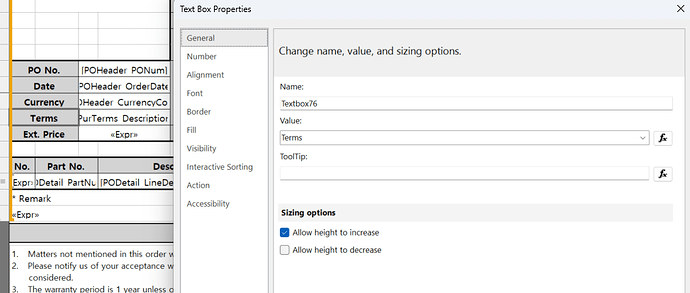

Maybe a good idea to check "what is the ‘Terms’ text box next to your changed PurTerms_Description box is bound to? "

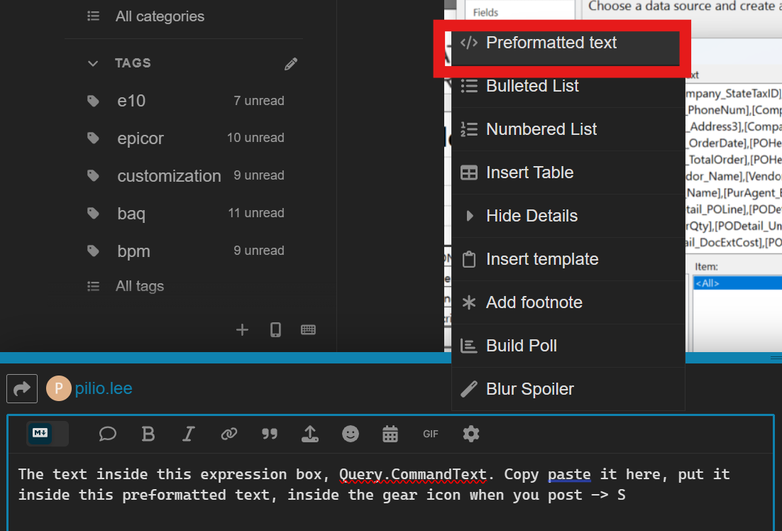

The text inside this expression box, Query.CommandText. Copy paste it here, put it inside this preformatted text, inside the gear icon when you post →
="SELECT [Company_Name],[Company_StateTaxID],[Calculated_Phone],[Calculated_Fax],[Calculated_Address],[Company_PhoneNum],[Company_FaxNum],[Company_Address1],[Company_Address2],[Company_Address3],[Company_City],[Company_State],[Company_Country],[POHeader_PONum],[POHeader_OrderDate],[POHeader_CurrencyCode],[POHeader_TotalCharges],[POHeader_TotalTax],[POHeader_TotalOrder],[POHeader_DocTotalCharges],[POHeader_DocTotalTax],[POHeader_DocTotalOrder],[Vendor_Name],[Vendor_VendorID],[VendCnt_Name],[Vendor_PhoneNum],[PurAgent_Name],[PurAgent_BuyerID],[PurTerms_Description],[PurAgent_EMailAddress],[PODetail_POLine],[PODetail_PartNum],[PODetail_LineDesc],[PODetail_IUM],[PODetail_PUM],[PODetail_OrderQty],[PODetail_UnitCost],[PODetail_ExtCost],[PODetail_DocUnitCost],[PODetail_DocExtCost],[PODetail_DueDate],[PORel_TranType],

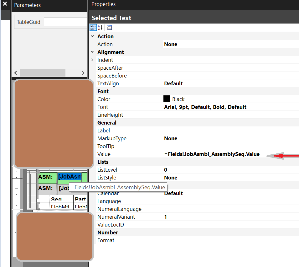

  1. Select the textbox that shows “Terms”.
  2. Look at the Value property for that box (on the proprties area usually to your right hand side on the screen) — that tells you what field or expression it’s using.
  • If it says something like =Fields!Terms_Description.Value then it’s bound to a dataset field.
  • If it’s just text it won’t be bound to anything.
If an expression still references a field that no longer exists in a dataset (like your old Terms_Description), that can cause the “invalid column” error when the report runs — because SSRS is trying to bind that textbox to a field that doesn’t exist in the dataset anymore.

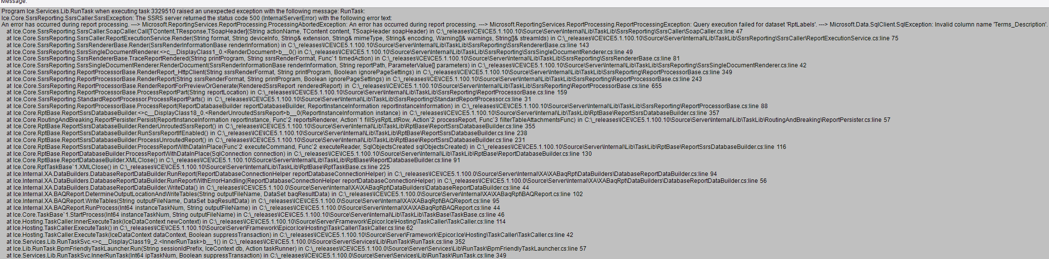

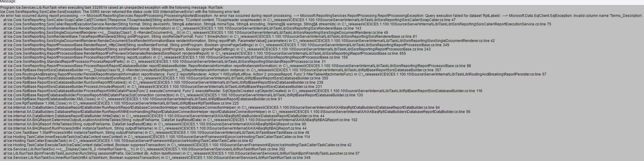

it’s just text. I removed Terms_Description from RptLabels and uploaded it, but it still doesn’t work. Below is the latest error message.
Like this one, can you do the same for RptLabels data set?
Yes
="SELECT [RptLanguageID],[DecimalsGeneral],[DecimalsPrice],[DecimalsCost],[GlbDecimalsGeneral],[GlbDecimalsPrice],[GlbDecimalsCost],[RptLiteralsPage],[RptLiteralsTime],[RptLiteralsUser],[RptLiteralsDate],[Company],[Name],[Company_Name],[Company_StateTaxID],[Calculated_Phone],[Calculated_Fax],[Calculated_Address],[Company_PhoneNum],[Company_FaxNum],[Company_Address1],[Company_Address2],[Company_Address3],[Company_City],[Company_State],[Company_Country],[POHeader_PONum],[POHeader_OrderDate],[POHeader_CurrencyCode],[Terms_Description],[POHeader_TotalCharges],[POHeader_TotalTax],[POHeader_TotalOrder],[POHeader_DocTotalCharges],[POHeader_DocTotalTax],[POHeader_DocTotalOrder],[Vendor_Name],[Vendor_VendorID],[VendCnt_Name],[Vendor_PhoneNum],[PurAgent_Name],[PurAgent_BuyerID],[PurAgent_EMailAddress],[PODetail_POLine],[PODetail_PartNum],[PODetail_LineDesc],[PODetail_IUM],[PODetail_PUM],[PODetail_OrderQty],[PODetail_UnitCost],[PODetail_ExtCost],[PODetail_DocUnitCost],[PODetail_DocExtCost],[PODetail_DueDate],[PORel_TranType],[Calculated_Type],[POHeader_CommentText],[PODetail_CommentText], [PurAgent_PhoneNum_c], [PurAgent_Name_c], [PORel_PORelNum], [PORel_RelQty],[PORel_DueDate] FROM dbo.[RptLabels_" + Parameters!TableGuid.Value + "]"
Looking at your earlier screenshot, you are missing a comma after [PurTerms_Description]
Did you also remove [Terms_Description], from the SQL expression in the RptLabels dataset? And also make sure you’re not using/referencing that field anywhere in the SSRS report?
Thanks to everyone who helped me here, I finally succeeded. There were [Terms_Description] left in some places, so I removed them all and uploaded it, and it was printed successfully.
