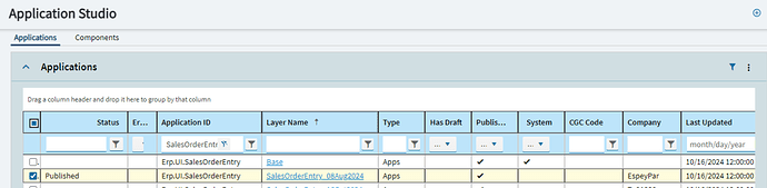

How do I delete a Kinetic Layer Draft? I have a custom layer that show both “Has Draft” and “Published” check in Application Studio.

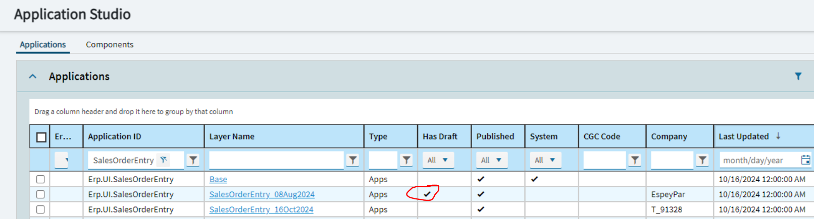

Today I needed to make an update and attempted to just update the existing custom layer “SalesOrderEnty_08Aug2024” but could not get my updates to show. I had published my changes so not sure why it also shows “Has Draft”.
To get around this, I made a copy of the custom layer to a new name and it now shows my changes. The new layer only shows “Published” so assuming the “Has Draft” was causing an issue on my prior layer.

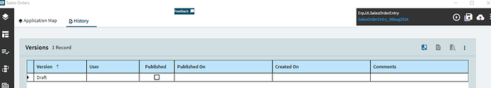

The layer in question only shows 1 version which is labeled Draft and the option to view is grayed out.
However, I just tried publishing it from Application Studio and that seems to have worked and removed the draft.
Then I proceeded to add the changes I needed to make, saved and published from the Layer. My preview is now showing the changes, however the Draft is back. Seems Saving and Publishing from the layer is creating the draft and only way to get rid of it is to publish from App Studio.
