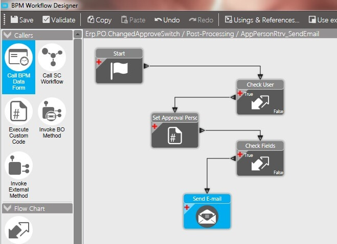

I’m now about to start practicing on BPM. But I’m stuck from the first step.
How can I open this BPM Workflow Designer?

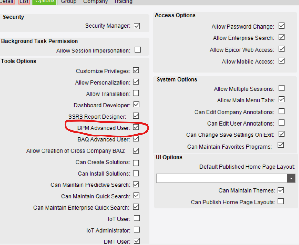

Your user needs permission to see it.

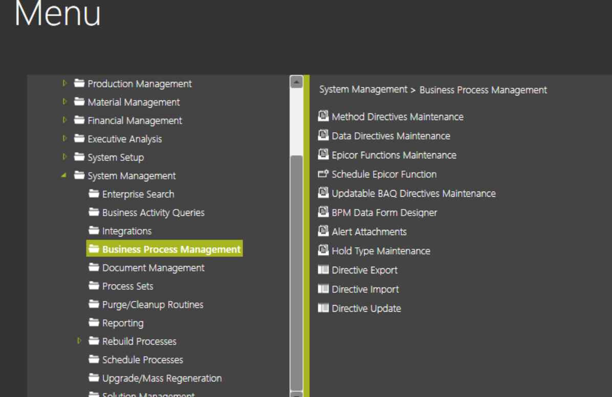

@pilio.lee Yes you have access, so the bpm designer is after the directive type you are going to make.
Under business process management find Method Directive Maintenance or Data Directive Maintenance.

It’s inside method directive or data directive maintenance
It is also inside the BAQ designer if you set your BAQ to updatable.
