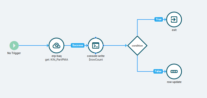

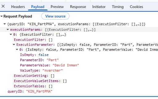

My ExecuteBAQ method details:
My event (currently):
