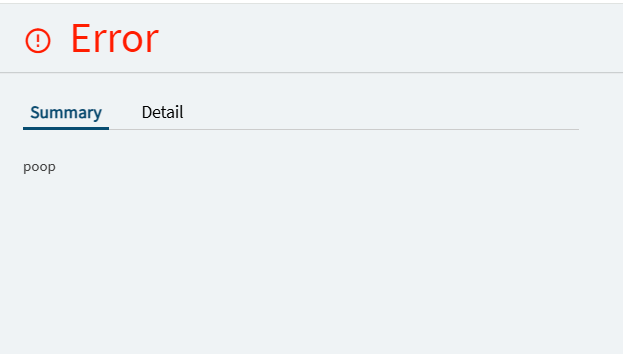

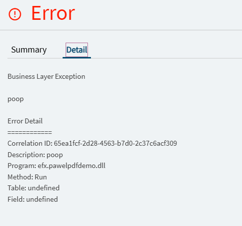

This is what happens:
Response
    "HttpStatus": 400,
    "ReasonPhrase": "REST API Exception",
    "ErrorMessage": "poop",
    "ErrorType": "Ice.BLException",
    "ErrorDetails": [
            "Message": "poop",
            "Type": "Error",
            "Program": "efx.pawelpdfdemo.dll",
            "Method": "Run"
    "CorrelationId": "65ea1fcf-2d28-4563-b7d0-2c37c6acf309"
Note, that’s if you catch it and throw a BLException.

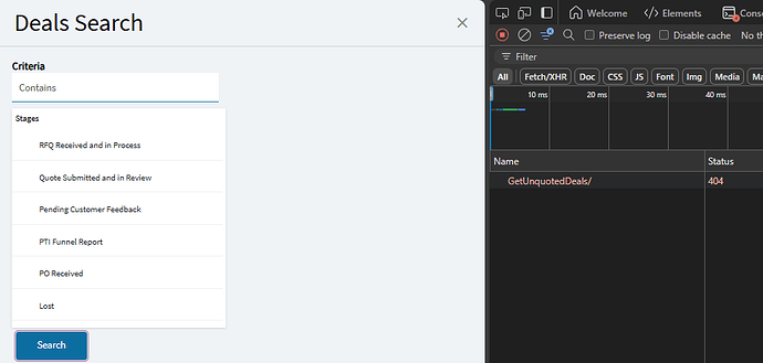

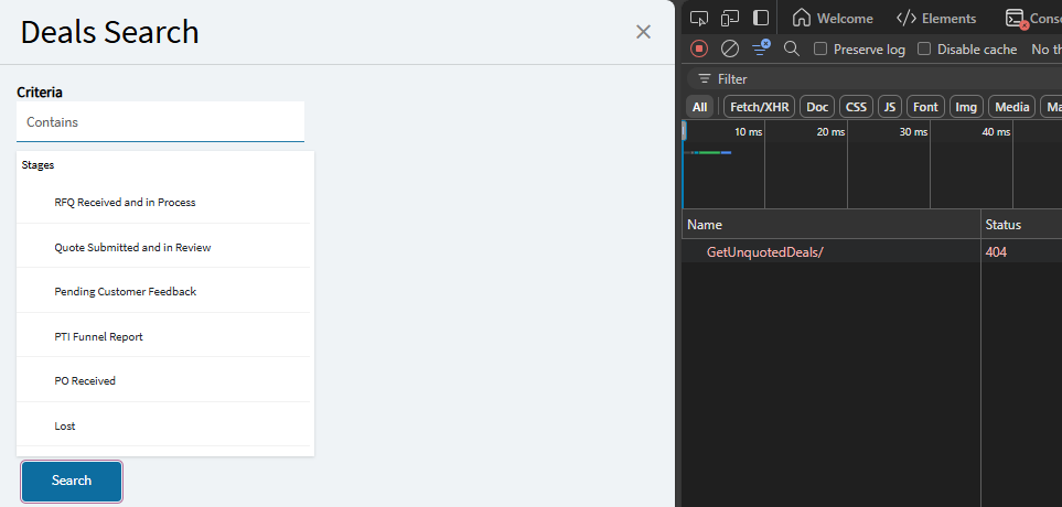

Maybe I’m doing something wrong. Clicking on search should call the function:
But I don’t get a dialog for error even though I have a 404. :thinking:
That on success thing seems to fire even when it fails. I usually direct on success to a condition, and then check for an error there.
