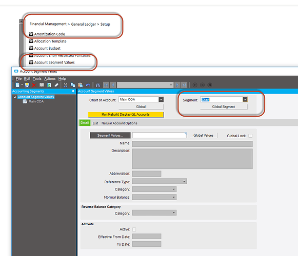

You need to create a segment value in segment value maintenance for each chart segment that will be used in the GL Account, based on your COA segments. Then under GL/Setup go to GL Account Maintenance and create a new GL Account

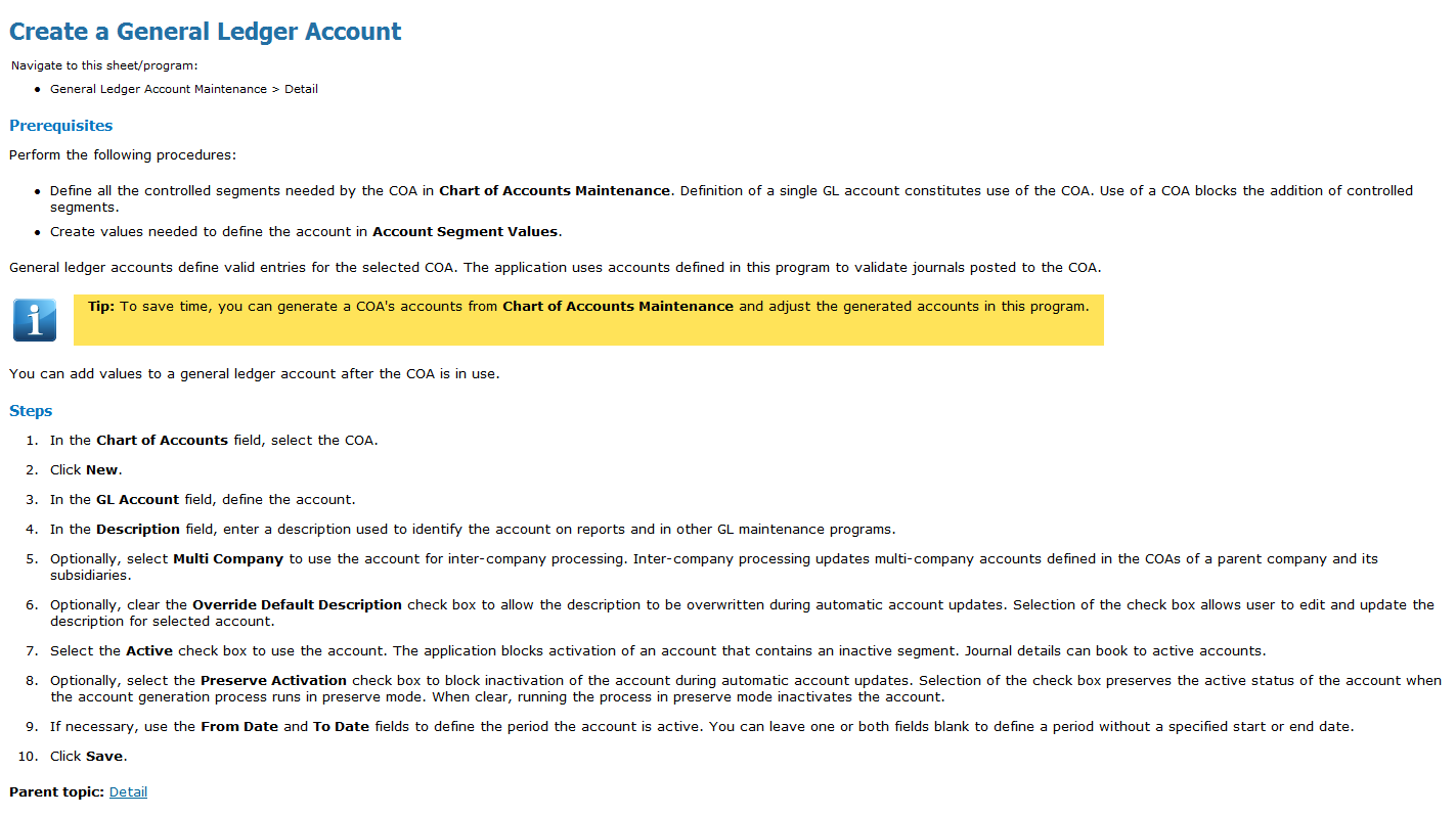

here is whats in help
Thanks, Craig! Now, how did you get there? I’m in Help now, and I searched for that article’s title and still can’t find it. I get so frustrated trying to look for help with Kinetic.

As others have said, the Account Segment Values need to be created first for each segment you plan to use. If your account segments already exist and you’re just creating a new valid combination you won’t need to do this.

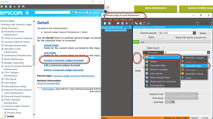

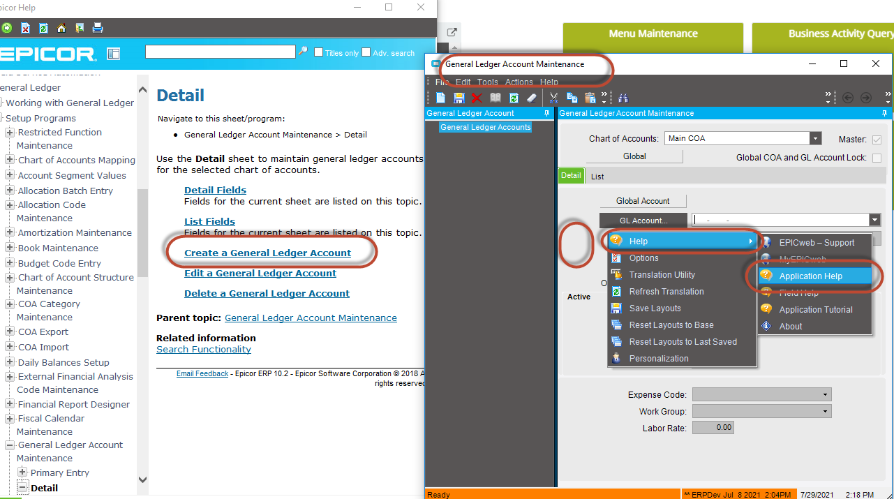

I just right clicked > help > application help. I find it easier to navigate Help when you open it from the application you need help on. It then takes us (usually) directly to the area of Help that we need.
Ok, I’ll do that, thanks. I have been opening the Help panel and typing in keywords, but it just doesn’t display all the help for that word. Same problem when I search in EpicWeb. That looks much easier!
Aha! You right-click on the form, not a field. I had no idea. So it brings up the same Help menu. Nice. I knew I could do this from a form, I just could not find General Ledger Account Maintenance because I was searching for “GL”.
You are fabulous, thanks for showing me that. Does this work in Kinetic forms too, or is that too much to ask for?
