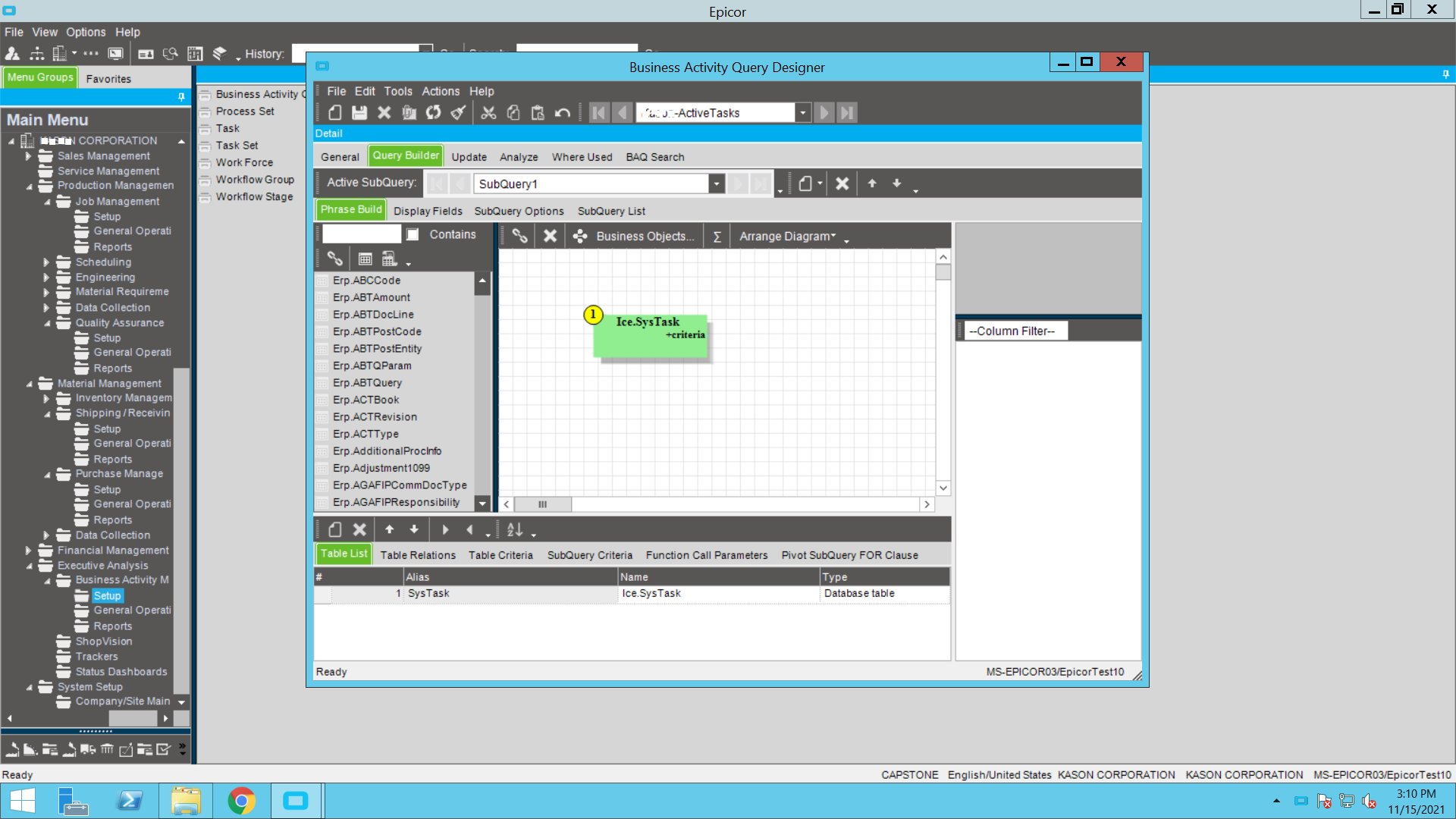

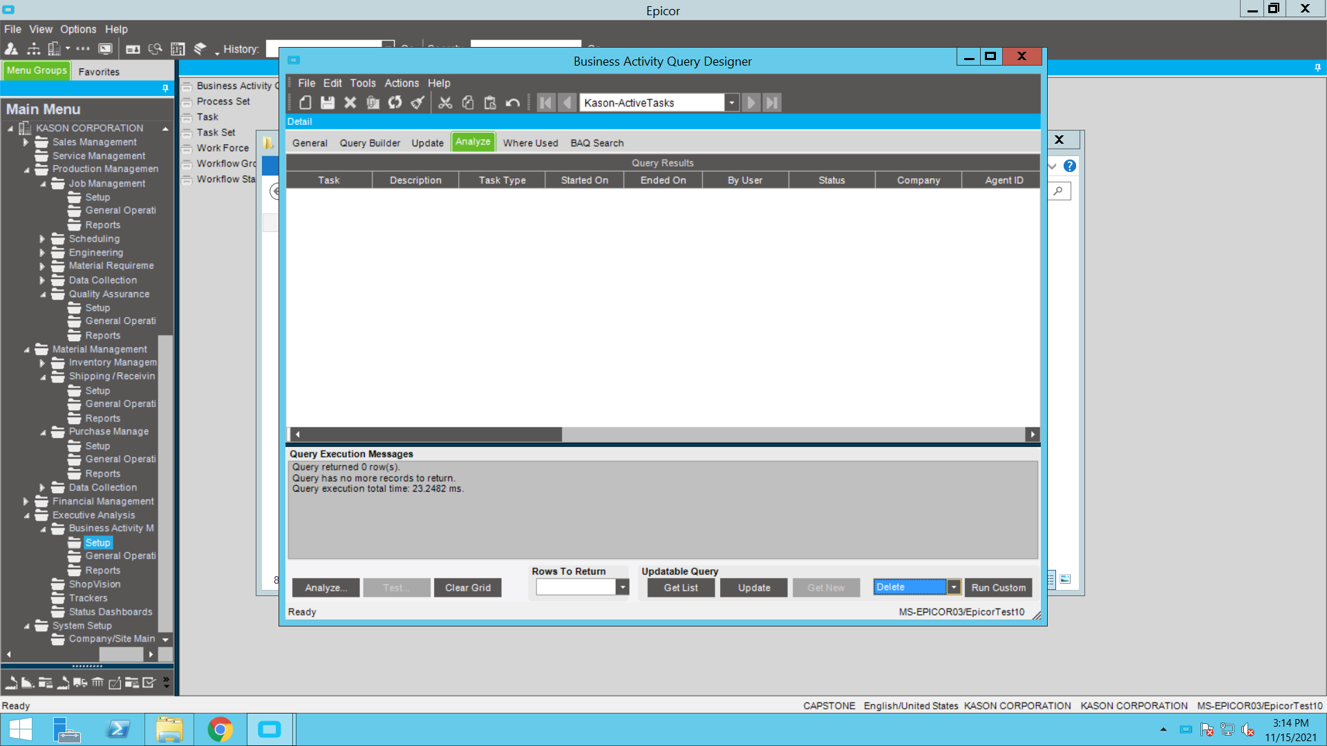

You can develop an updateable BAQ against the ICE.SysTask and define a custom delete action. When you run the BAQ, select the stuck task and then run the custom action to delete that task

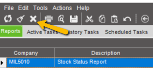

Open system monitor and press on the x. It does take a while for some of the bigger tasks e.g. 30 seconds

Hey Matt,
Does that work for Calculate Global Scheduling Order? It didn’t do anything when I tried last night. I had to use the BAQ @mjfwagner suggested.
Hey Mark,
Thanks for the post, this worked perfectly.
