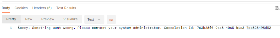

Yes.
I mean when Postman says “Something went wrong,” I don’t expect it to have worked lol.
Maybe I should have started there. But it’s not much of an error.

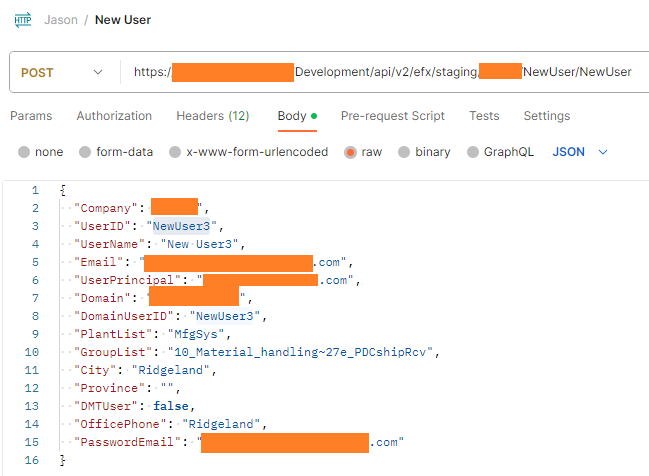

Can you make your callm in SWAGGER?
What does your call look like in REST / JSON

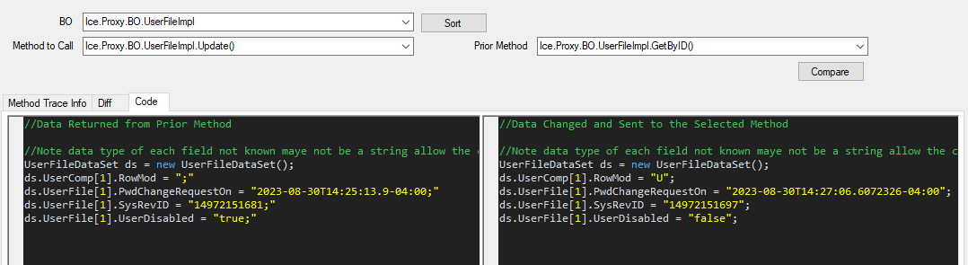

Here’s a trace in the DMT, which works and does not send an email (a la the EAC):
Right. It’s just setting UserDisabled to false. The UI’s also call ResetPassword just to be friendly.
Are you setting the RowMod to “U”?
And I see the PwdChangeRequstOn date there too. Setting that?

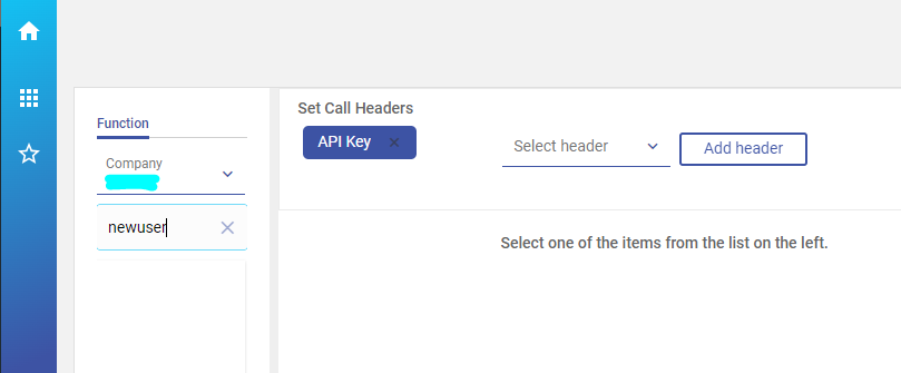

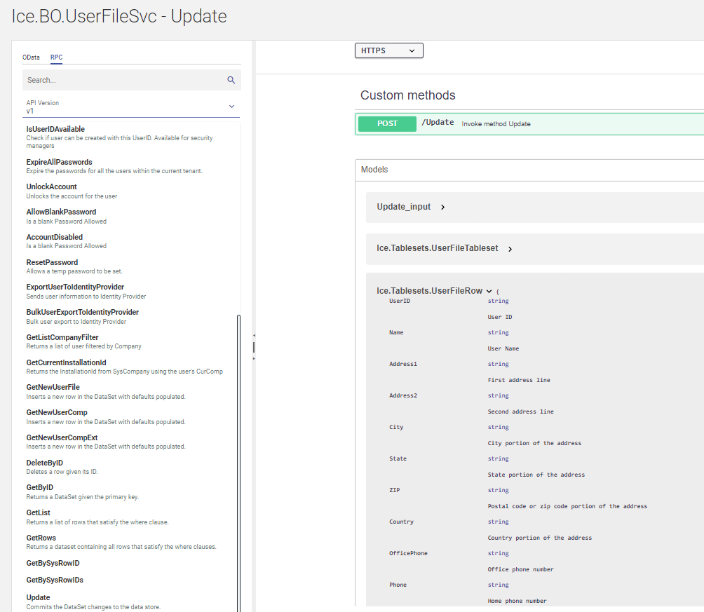

This guy?

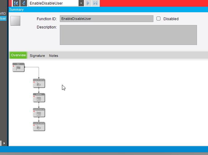

Functions don’t seem to load there.
Maybe you mean just calling the Update method here, without a Function?
I’d try without the function first. This guy:

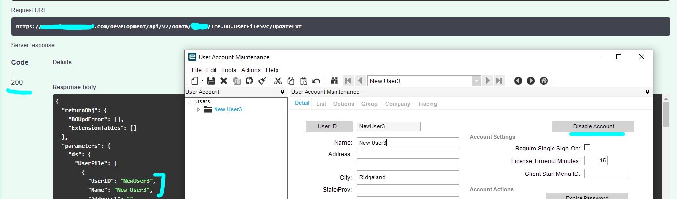

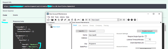

I patched https://host/server/api/v2/odata/COMP/Ice.BO.UserFileSvc/UserFiles(‘wcambell’) with just below and it works fine
"UserDisabled": false,
"RowMod": "U"
