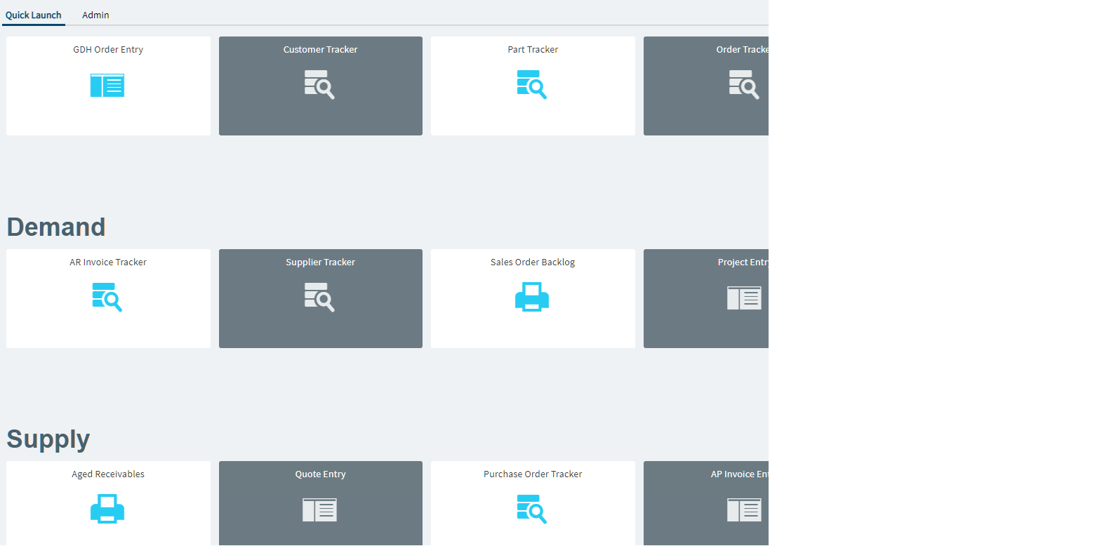

I just lock everybody out of Pilot besides myself by default, and if someone needs access to test, I’ll configure their home page with alternating colour tiles of grey and white, and change the top text label to read ‘PILOT ENVIRONMENT’.
Once they’re done testing, account disabled.

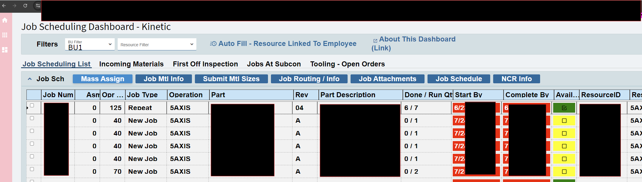

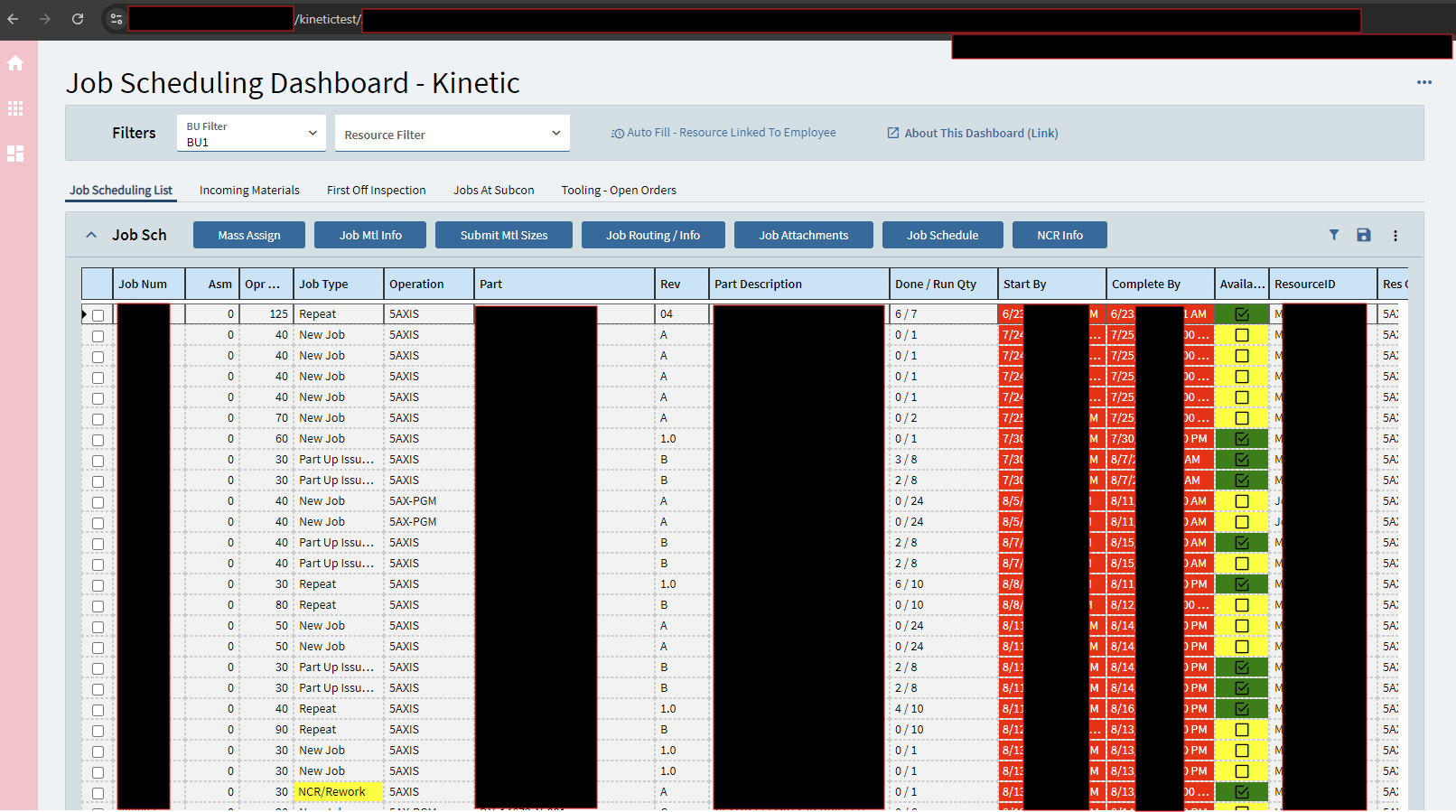

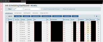

Not sure that I would say wizard, but I have been messing about with setting something up to overcome some issues we’ve seen with styling. Many of which are made redundant by 2024 but others might still find them helpful and it is (almost) infinitely extensible. You can find a basic implementation on Github, which you can copy and edit to fit your own needs should you want to. This will only help you if you are browsing kinetic via Chrome.

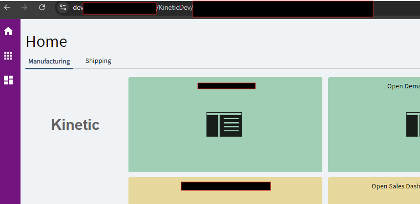

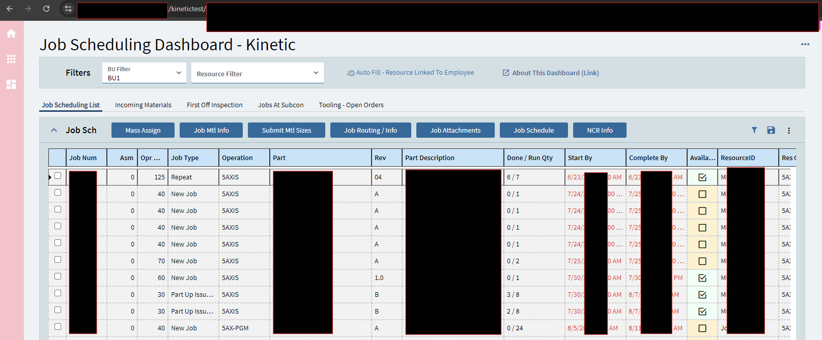

In practice I have inserted a few styles that were helpful for us, reducing the grid size to fit more information on the screen, changing the colours back to be more contrasting, and changing the colour of the main menu bar to indicate which environment we are on. But there are no limits to what could be done.
For example, on our Test environment a nice pink colour.
And a nice purple for dev.

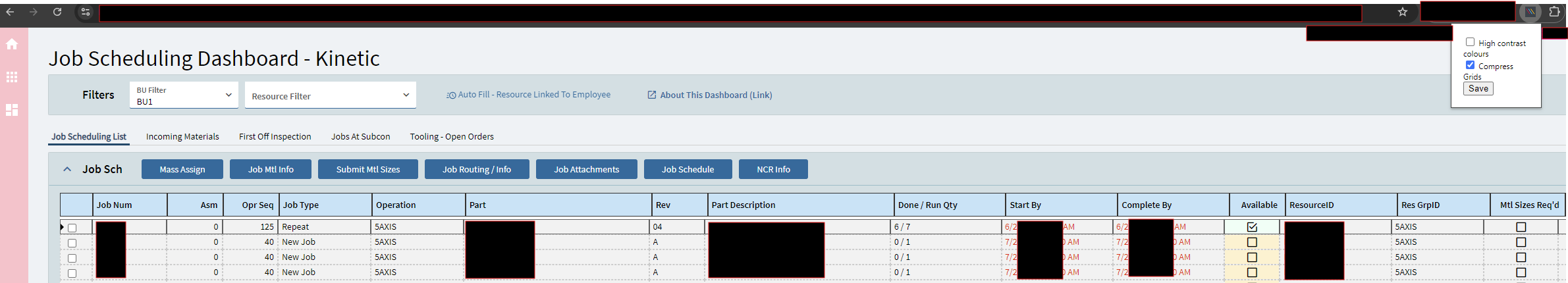

And if you wanted to toggle on the Brash colours and compressed grid, then here’s an example of what else can be done quite easily. Any number of styles could be added.
And the Accessibility mode can be set up with anything that the user needs.

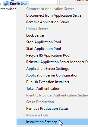

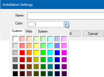

Ha, me too! But it’s just the URL bar at the top (the EAC setting). I didn’t actually do anything novel.
