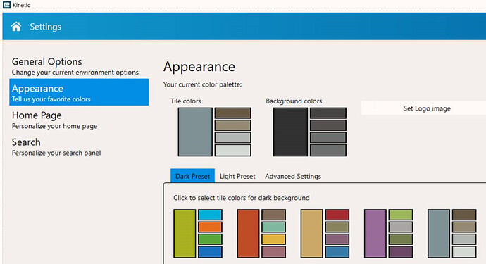

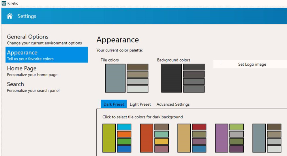

You can try going into settings > appearance. You also have the option to load images.
Then mess around in here. We’ve had mixed results with this but at least it’s a starting point for you.
Hope this helps.
-B
Yeah, every time I get a new pilot database, I go right in there and go to Advanced Settings to change the background colors. I change all the various shades of grey to various shades or red. so as long as my screen is red I know I am in pilot. You have to do this every time Pilot gets updated from Live.

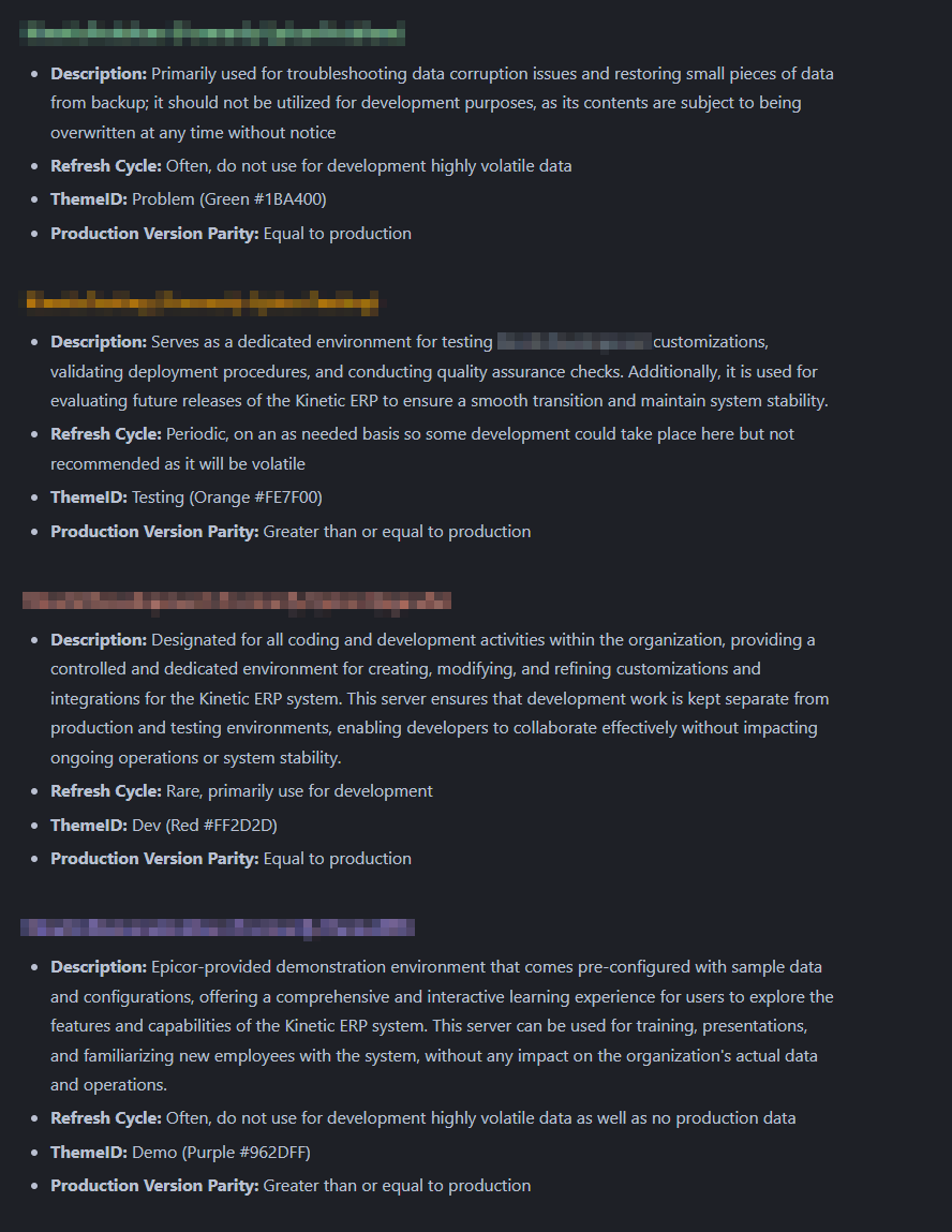

Having an environment dedicated to bug fixes / troubleshooting is a great idea. I’m stealing it. I normally use my dev environment but that can be trouble when in the middle of actively developing something.
Yeah Problem stays offline most of the time but if I have a issue report for data that was corrupted and I need to restore to a specific minute that’s the place we dump it knowing it’s highly volatile do not develop in it at all.

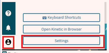

Can this be done in the kinetic cloud environment or do I have to access from the client?
Yes. The screenshots I posted are from a local client installed for a cloud based environment.

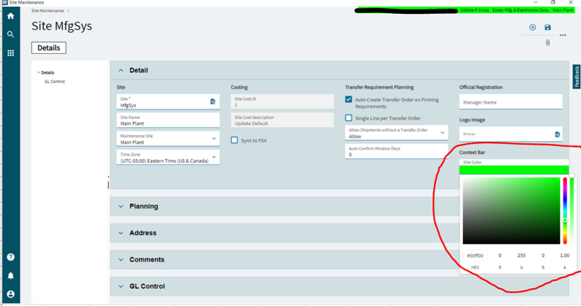

We use a different color on the top content bar to make Kinetic menus look different for our Pilot environment.
Navigation: System Setup > Company/Site Maintenance > Site Maintenance > Main Plant
For Classic we use a theme that is set for all users which changes the top/bottom areas to green
In both Kinetic and Classic we have to redo this after each upgrade or anytime we request Pilot to be refreshed.
