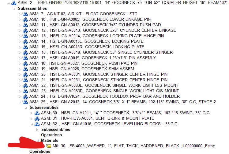

Is there a way to search for a specific material part number in a job with multiple assembly’s?
I would like to find the part with the red arrow but I have to know the assembly to find it.

It only show the material in the sub assembly you selected. I am running Epicor 10. I need to search all sub assembly’s for the material part number.

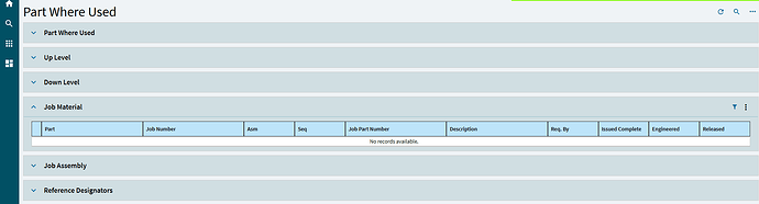

I think if you have the Executive Analysis module, there is a Part Where Used tracker that does the trick:
This does exist in E10.
