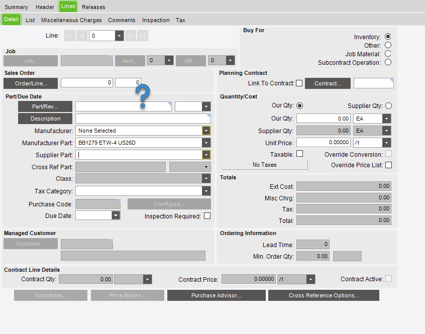

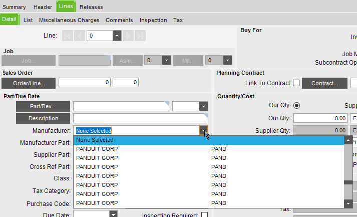

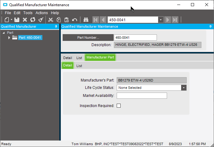

How does one use the Manufacturer and Manufacturer Part for Part Entry on a PO Line. We have Manufacturer records defined, yet when I click the drop down, I get a list that appears to be a line for every Qualified Manufacturer Part record

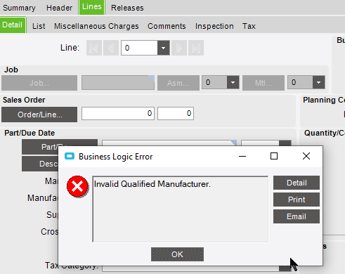

and when I make a selection I get an error.
I would expect that if I entered a Manufacturer Part (number) in the field, that Epicor would return the rest of the information on the associated Part record, but it doesn’t.
What am I doing wrong?
I don’t use this… but you may need to enter YOUR Part number first (that’s what you’re buying)… and then that may filter the Manufacturer list down to those linked to YOUR part number?
