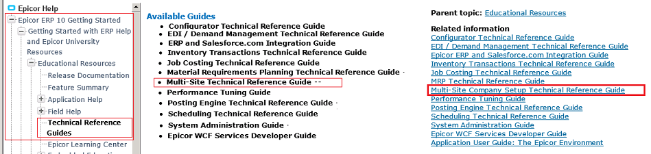

(I believe) Epicor Help includes a link to the PDF “Multi-Site Company Setup Technical Reference Guide”. Where one of the first sections is “Multi-Site Concepts”… might help.

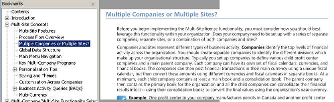

That document does provide some examples of when you might want a different site, such as when manufacturing centers have different production schedules. But in some ways, the examples they give are radically different from what I’ve seen in practice:
Your company manufactures pencils. One site shapes the wood required for each pencil, drills the hole for the lead, and then packs the lead inside each pencil. Another site manufactures the erasers for the ends of each pencil. Then a third site attaches the erasers to each pencil body. In order to define the production schedules, costing methods, and inventory processes, you create the WOOD, ERASER, and ASSBLY sites.
Maybe that’s just a terribly contrived example, but those sound like operations to me, not reasons to create sites. That’s why I’m curious what people have actually done in practice.

Looks like I remembered correctly - ref links I see in E10 Help.
Yes… some parts of their examples are kind of weird…pencil, eraser assembly sites?
However, this line…
