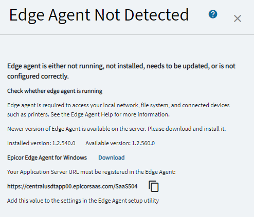

I had it installed on 2024.1.x. We upgraded to 2024.2 over the weekend on cadence in the cloud. Now, Edge Agent appears to require user interaction and download/installation to update, different from how the smart client works.

Another fun fact… as I was tasked with testing out Edge Agent as well… so I started with me as the guinea pig, and then tested with our accounting department. All went fine until I got to our AP Clerk… and kept getting this popping up every time she tried to print something.
Unbeknownst to me, my predecessor had tried installing it on her computer… and thus she had an old version installed. I ended up completely uninstalling Edge Agent from her computer, deleting out ALL edge agent files of any kind, and then installing Edge Agent on her computer properly… and it worked without any issue.
Epicor Support isn’t going to be able to tell you that. Their base assumption is that you did something wrong installing it. Newer versions of Edge Agent don’t “overwrite” the older versions when installed. So just be aware if one specific user’s computer is resulting in that error, when everyone else is working just fine… they may have ended up somehow getting a different version installed from the one deployed on your server.
