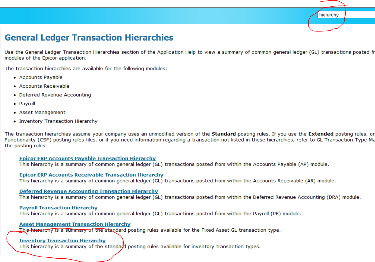

I would also check out Help (Press F1 from any module) and search for keyword “hierarchy”. These guides explain how the Epicor transaction post to the GL and what GL control lines are in play.
