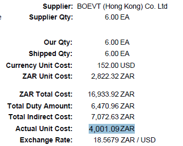

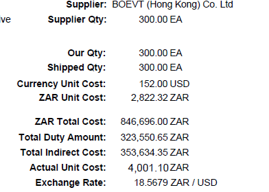

Hello all ,i am trying to arrive at the same Actual landed cost as per the Landed Cost Report… on line 1.R4001.10 instead i arrive at R5079.60 please see below screenshot

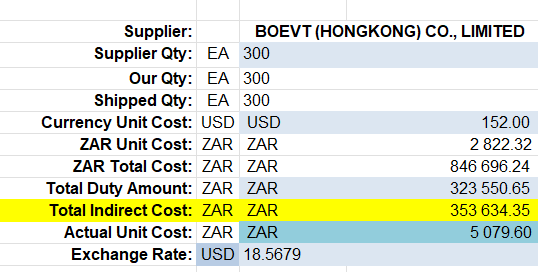

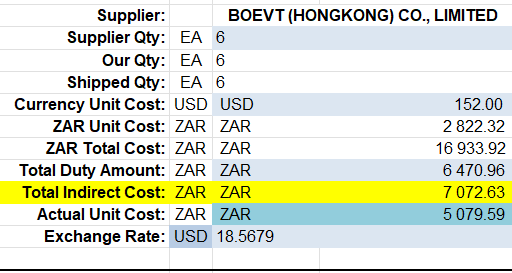

Line 2 below is the same but when i calculate it on excel i am arriving at a different fi
gure

Your excel calculation is:
“Actual Unit Cost” = (ZAR Total Cost + Total Duty Amount + Total Indirect Cost) / Qty
But it appears that Epicor’s calculation is:
“Actual Unit Cost” = (ZAR Total Cost + Total Indirect Cost) / Qty
Epicor is not including the Duty cost in their actual unit cost.
Is this correct… can it be changed… :man_shrugging:
Since both lines have the same (USD) unit cost, the result should be very similar. I believe the slight difference (4,001.09 vs 4,001.1) is just a factor of scale/rounding.
(16,933.92 + 7,072.63) / 6 = 4,001.092
(846,696.24 + 353,634.35) / 300 = 4,001.102
