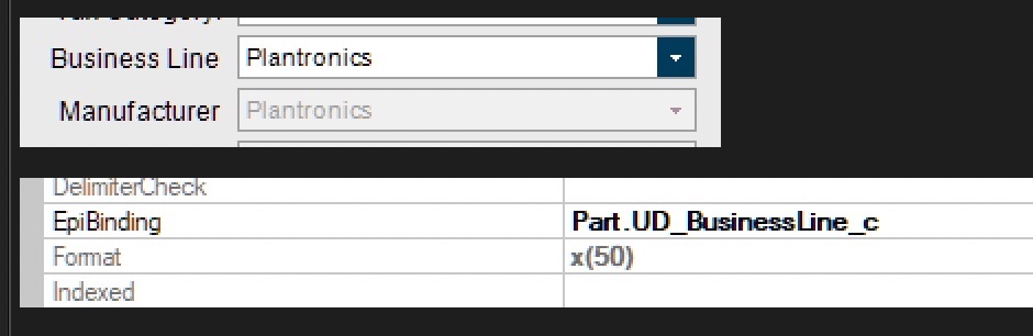

An example of how we do this with a baqCombo control is with our Part screen, all of our Parts have a business line on them. I display the manufacturer associated with that business line underneath, using a baqCombo to display the value. That way I don’t have to code for another adapter just to display that value.
Thanks again Marjorie! I might just try that. It might eliminate the necessity of creating a new view with other adaptor, though it would always have just one value, contrary to the idea of a combo. But who cares? I’ll look into it. Thanks again!
