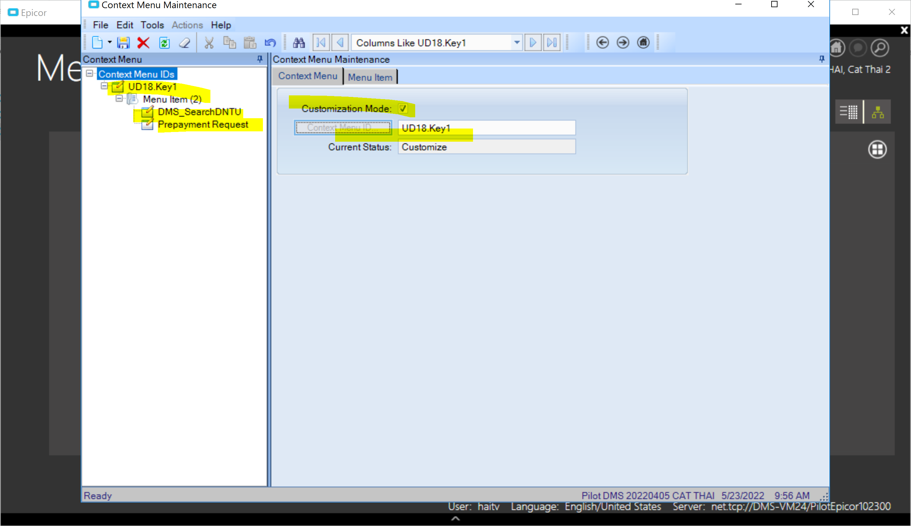

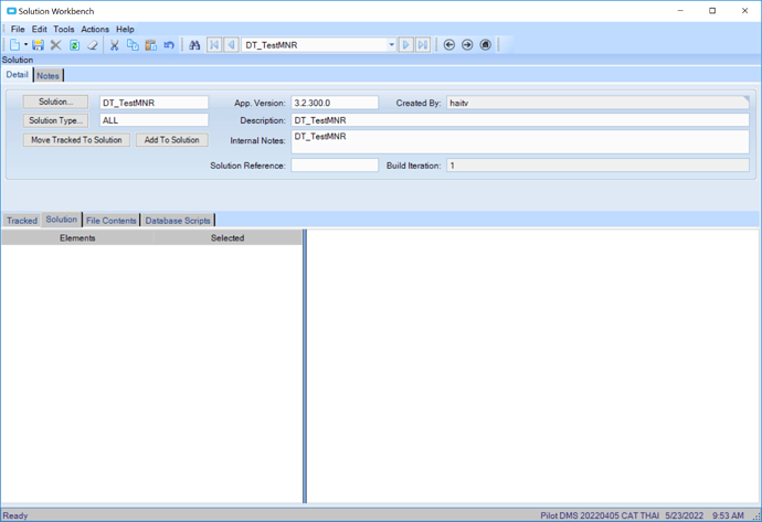

How to add context menu to solution?

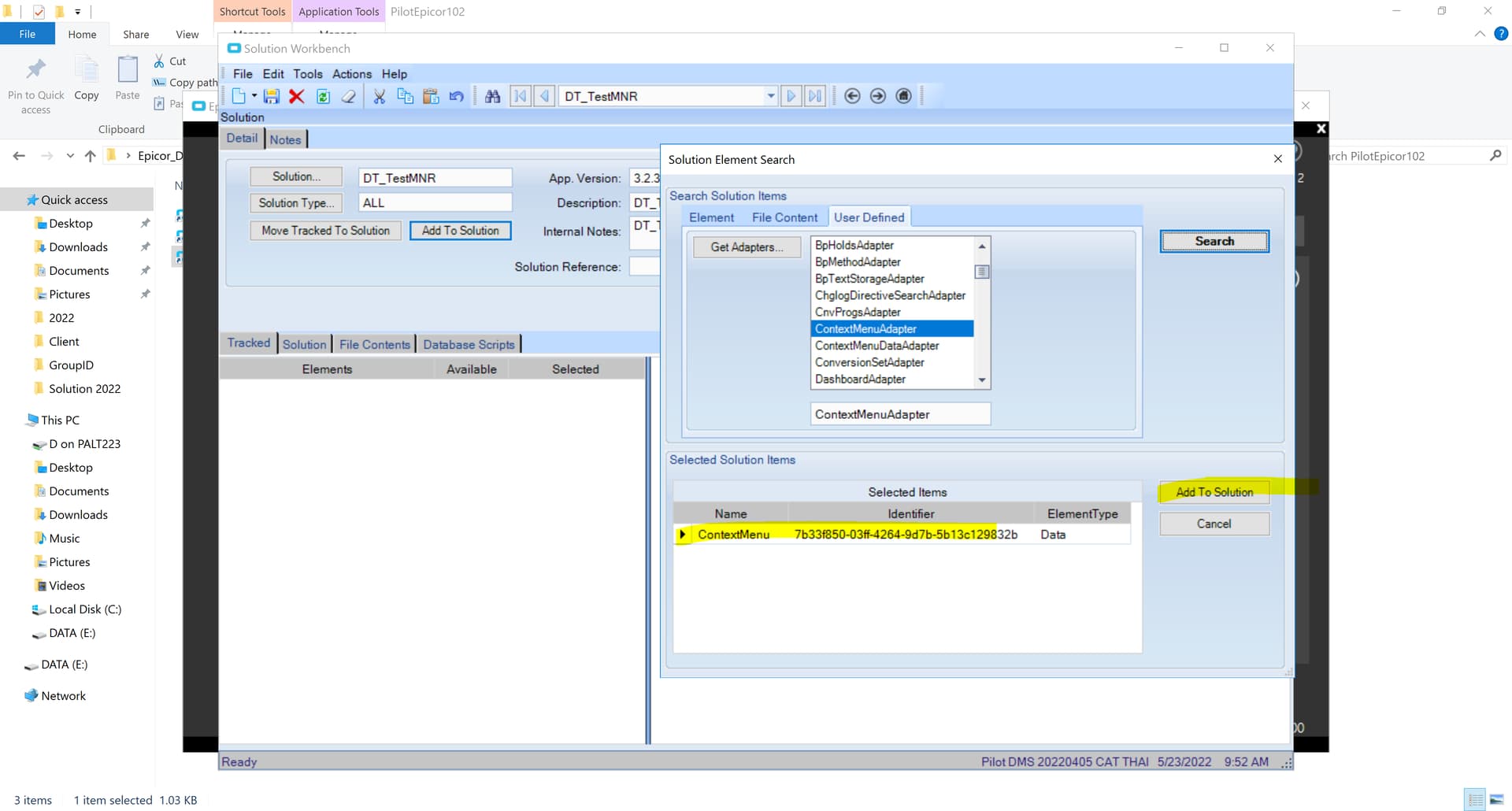

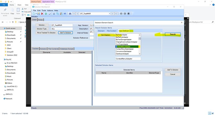

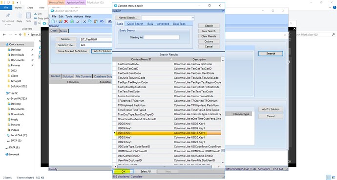

I have created the context menu but can’t add it to the solution when building:

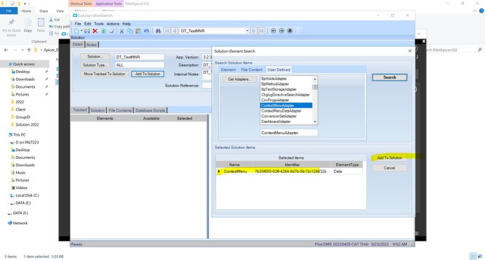

When i build the solution i want to add it:

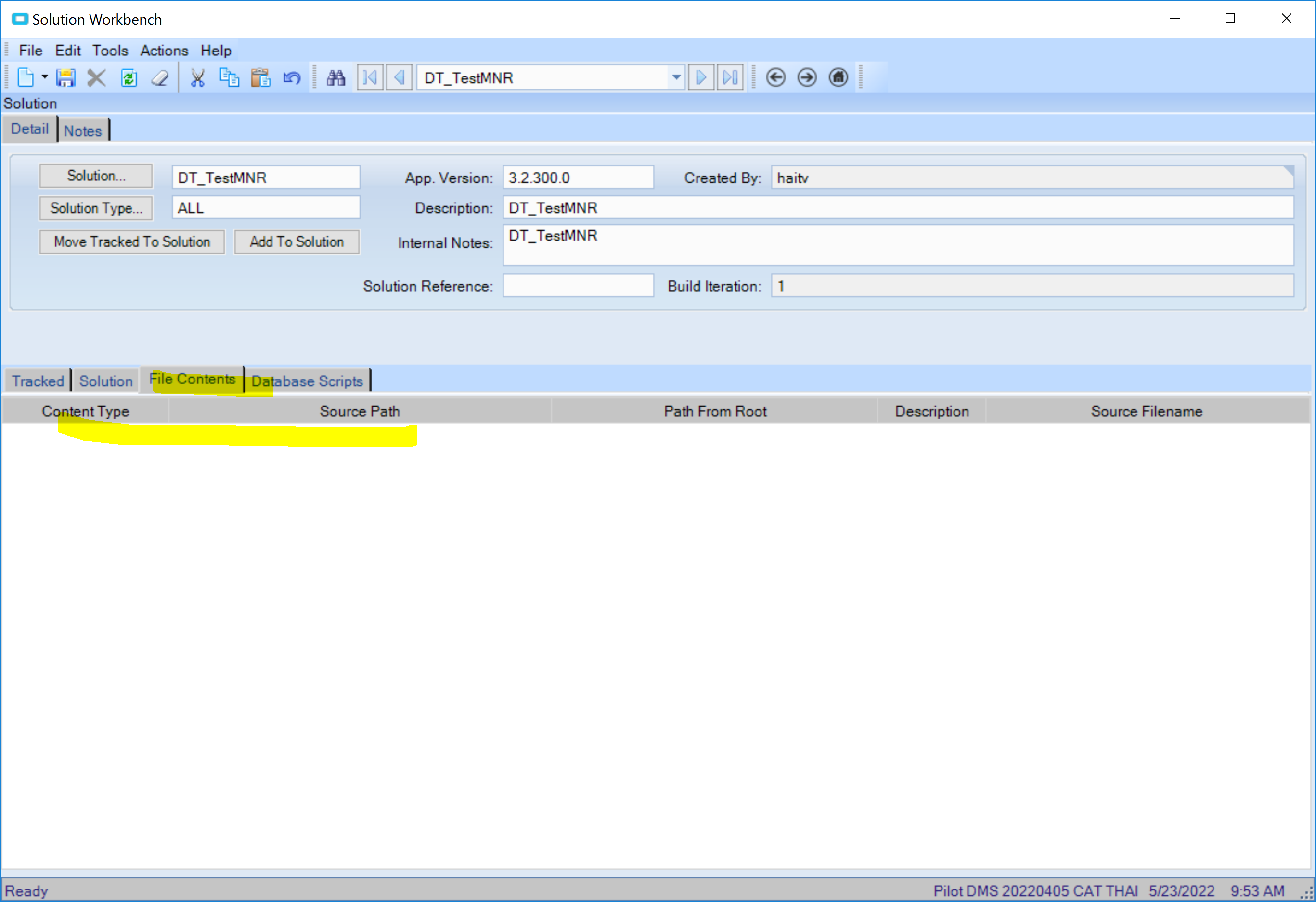

After adding I can’t see it anywhere

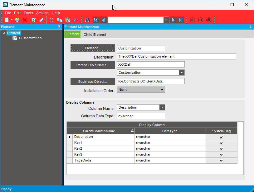

You might need to create a new Solution Element using Solution Element Entry and base it off Customization, and change the Key
Look at what Customization has and do the same for Context Menu, because the Customized Context Menus live inside Ice.XXXDef just like a Customization.
You may even have to base it of Ice.XXXDef because when you Customize a ContextMenu it adds the entirety of Epicor XML in addition with your overrides inside a single row, if I recall.
SELECT * FROM Ice.XXXDef WHERE TypeCode = 'ContextMenu'
select Content, * from Ice.XXXDef where Key1 = 'CustomContextMenu'
