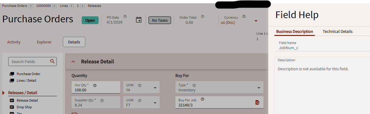

I have a custom field that I added to PORel.JobNum_c.
The fields works just like it should, except that there is no field level help description. How do I add that in? Is it possible?
I can see the description I created in UD Column Maintenance but its only in the technical details side:

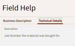

Go to UD Column Maintenance (same place you’d have created the field) and open the UD Table, then open the Field itself. Fill out the Description, which will then appear under the Technical Details (but sadly not the Business Description).

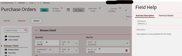

You can populate the business description too now in (2026.1, maybe 2025.2 too?) - but you need the “Productization” license, according to the error the BO gives me when I try and update.
Edit: Looks like it’s there in 2025.2.16
