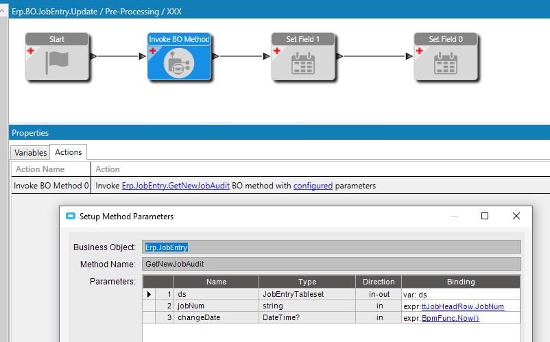

You didn’t tell us what BPM you want to use. When you add a record, it usually goes like this:
  • call GetNew
  • set your fields

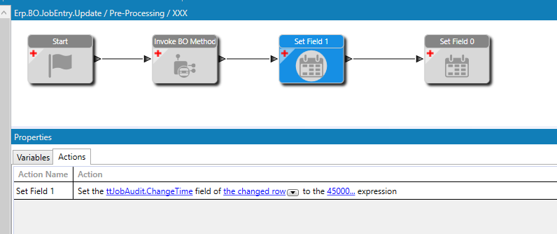

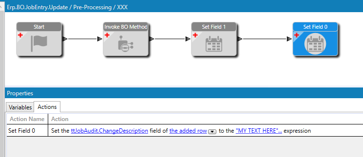

  • call Update
