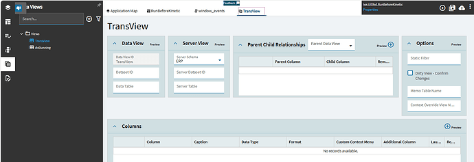

  3. Add a dataview called TransView. Dont make any changes, just save it.
  4. Add a textbox to the grid header, call it PartNum. Epbind it to TransView.PartNum.

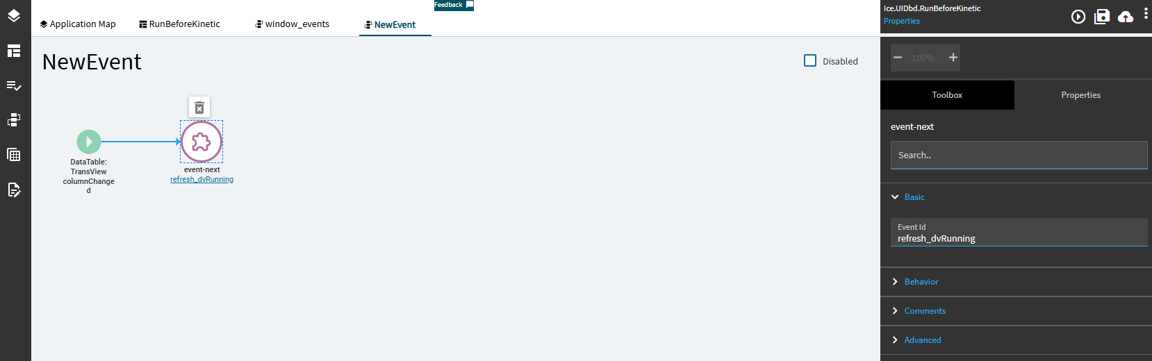

  1. Add the event to refresh the form when editing the part number field. This is a DataView: TransView Column Changed (PartNum). And the next event is pointing to the refresh event that the wizard created for you.

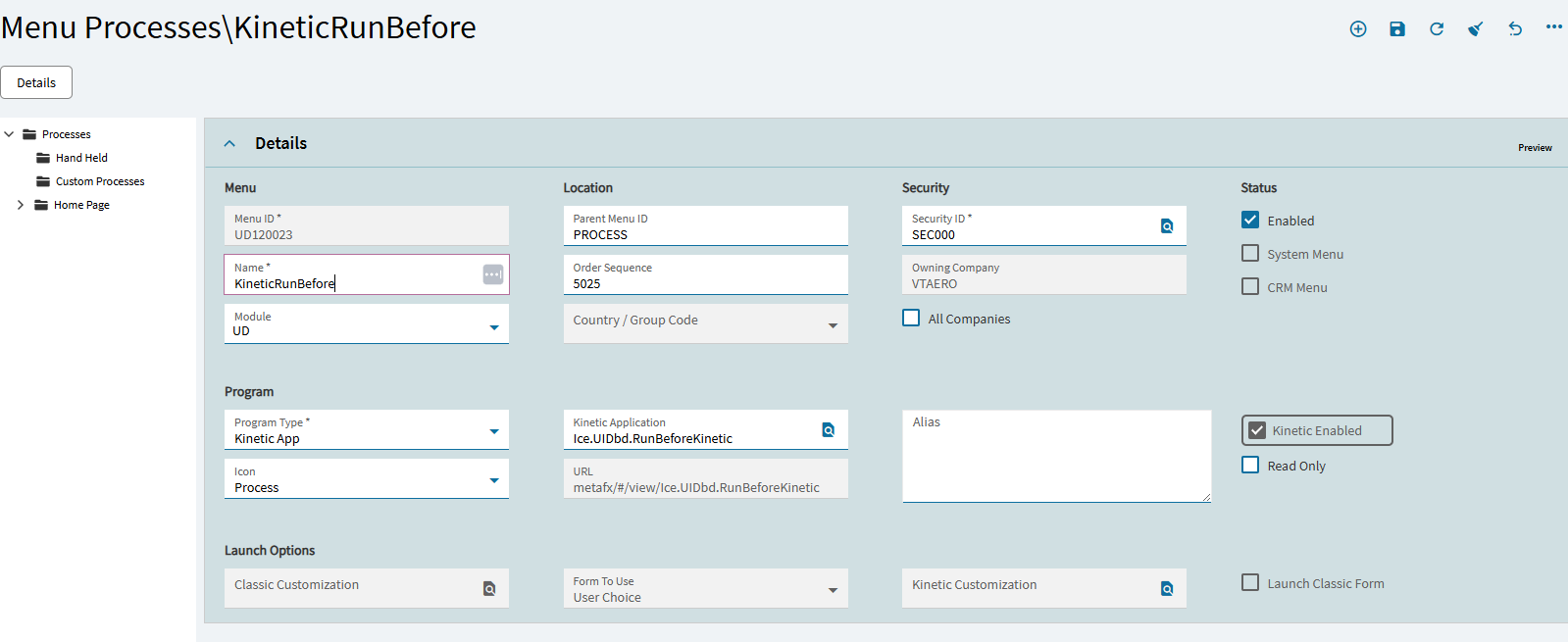

  2. Add menu item (process) for new App. Use Menu Maintenance.
  3. Using Context Menu Maintenance, add context menu item for Part Entry form to point to new menu process item. Note here that the process ID is the Menu ID from the previous step.

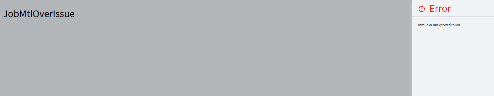

Did you ever get an error when trying to test opening the dashboard via the context menu that reads: “Invalid or unexpected token”
After I click OK, then it’s just the name of my dashboard without the grid or anything else.
What’s puzzling me is creating the TransView, but when EpBinding the text box, a PartNum column doesn’t even exist (no columns for that matter).
In this post I figured out that there is some jiggery-pokery going on behind the scenes: Custom Part Context Menu Open With - Kinetic ERP - Epicor User Help Forum

It looks like Nates post may have curly double quotes so simply changing to regular double quotes may be the fix. Watch out for copy-pasta issues on this site.
"%session.context.initialValueIn.ValueIn%"
Your error:
The expression evaluation is choking on your input key expression.
Look in dev tools and you’ll see somethin like this:
First, what field is your context menu on and is it text or number? If text, then Nate’s expressions should work (minus the bad quote characters). If number, try removing the quotes both double and single in both filter and row-update expressions.
It was the quotes. As soon as I deleted and manually typed them in, it worked!
