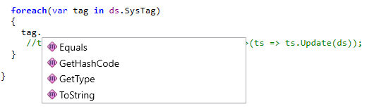

I’m not sure if I should be using Ice.BO.SysTagDataSet, or a “tableset” which I’ve seen in other places, but that is what’s called in the trace file.

This is all I can see from the intellisense.
Any help would be greatly appreciated!

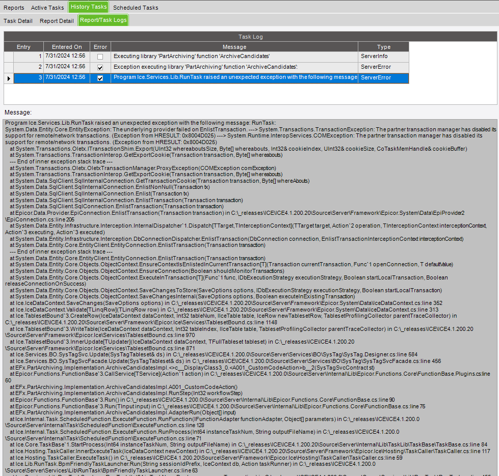

But I get this exception when I include the Update method.
Where would you go from here, or what should I be looking into next to figure out what’s wrong? This was run from the “Schedule Epicor Function” menu item.
I assume you are running this in a loop?
Try checking Requires Transaction on your function.
I’m speechless… Thank you, that fixed it, and everything is working now. I really don’t know how you guys learn all this stuff. The Field Help for that checkbox doesn’t provide any information on what its for. Maybe it does in a later version. But I can’t thank you enough. Thanks again!
