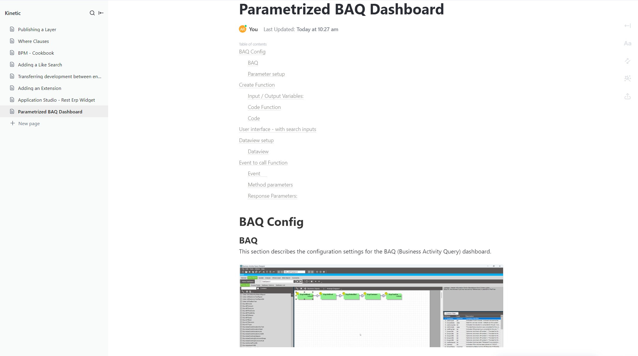

Parametrized BAQ Dashboard
BAQ Config
BAQ
Parameter setup
Create Function
Input / Output Variables:
ridgea:
BAQ Config
BAQ
Parameter setup
Create Function
// Code function:
// 1. Call dynamic query service, execute a query using dynamic parameters.
// 2. Ingnore any paramteres with null or emptry string values.
// 3. Call BAQ using parsed parameters, BAQ will handle skip condition if empty based on validation perfomred on IsEmpty validator: String.IsNullOrEmpty(‘paramter’).
// 4. Return results from BAQ executuion and parse values back into dataset.
CallService<Ice.Contracts.DynamicQuerySvcContract>(dQ => {
// Create a new instance of QueryExecutionTableset
Ice.Tablesets.QueryExecutionTableset dsQueryExecution = new QueryExecutionTableset();
//Create a new ExecutionParameterRow for the 'JobNum' parameter
ExecutionParameterRow drRow = null;
drRow = new ExecutionParameterRow();
drRow.ParameterID = "JobNum";
drRow.ParameterValue = this.JobNum;
drRow.ValueType = "nvarchar";
drRow.IsEmpty = String.IsNullOrEmpty(this.JobNum);
drRow.RowMod = "A";
drRow.SysRowID = new Guid();
// Add the 'JobNum' parameter to dsQueryExecution
dsQueryExecution.ExecutionParameter.Add(drRow);
// Create a new ExecutionParameterRow for the 'PartNum' parameter
drRow.ParameterID = "PartNum";
drRow.ParameterValue = this.PartNum;
drRow.IsEmpty = String.IsNullOrEmpty(this.PartNum);
drRow.RowMod = "A";
// Add the 'PartNum' parameter to dsQueryExecution
// Create a new ExecutionParameterRow for the 'Desc' parameter
drRow.ParameterID = "Desc";
drRow.ParameterValue = '%' + this.Desc + '%';
drRow.IsEmpty = String.IsNullOrEmpty(this.Desc);
drRow.RowMod = "A"; drRow.SysRowID = new Guid();
// Add the 'Desc' parameter to dsQueryExecution
// Create a new ExecutionParameterRow for the 'CustID' parameter
drRow.ParameterID = "CustID";
drRow.ParameterValue = this.CustID;
drRow.IsEmpty = String.IsNullOrEmpty(this.CustID);
drRow.RowMod = "A";
//Add the 'CustID' parameter to dsQueryExecution
//Create a new ExecutionParameterRow for the 'PONum' parameter
drRow.ParameterID = "PONum";
drRow.ParameterValue = this.PONum ;
drRow.IsEmpty = String.IsNullOrEmpty(this.PONum);
drRow.RowMod = "A";
//Add the 'PONum' parameter to dsQueryExecution
//Execute the query using the BaqID and dsQueryExecution
this.returnObj = dQ.ExecuteByID(this.BaqID, dsQueryExecution); });
User interface - with search inputs
Dataview setup
Event to call Function
Method parameters
JobNum (EpBinding: Search.JobNum)
BAQ ID (Your BAQ ID)
PartNum (EpBinding: Search.PartNum)
PartDesc (EpBinding: Search.PartDesc)
CustID (EpBinding: Search.CustID)
PONum (EpBinding: Search.PONum)
Response Parameters:
Now your grid is ready to be bound with the appropriate columns produced with the dataset
Dataview setup
Method parameters

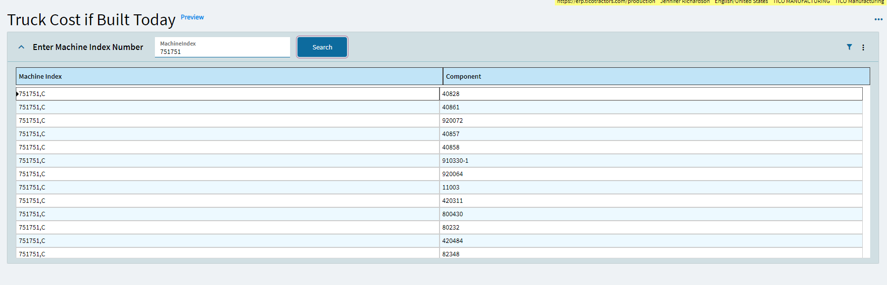

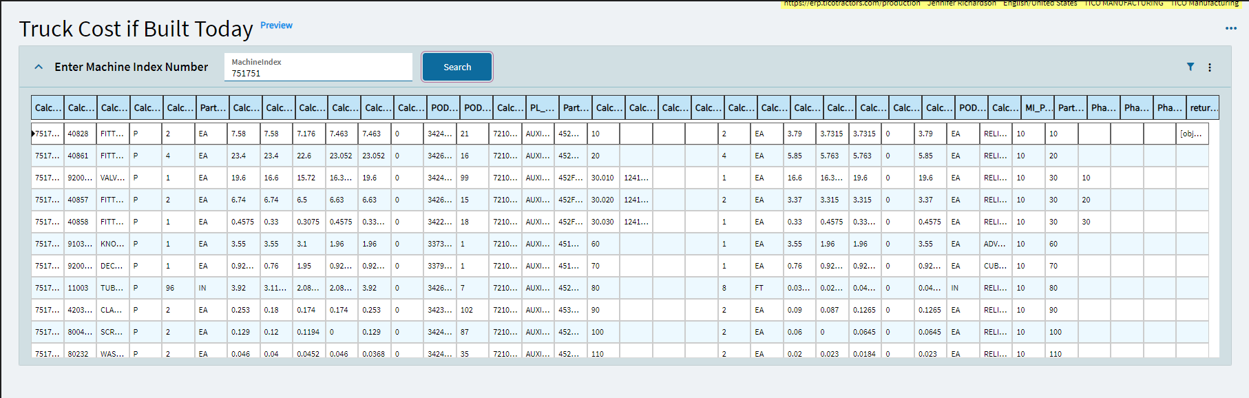

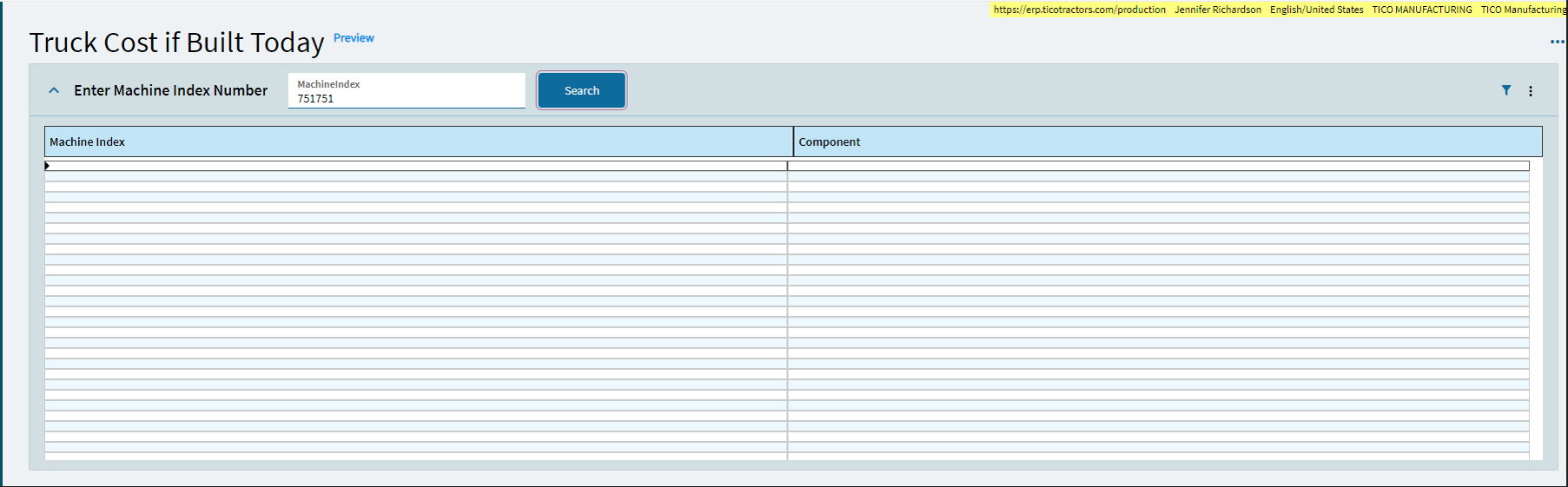

jrich2624
(Jennifer Richardson)
January 9, 2024, 2:03pm
10

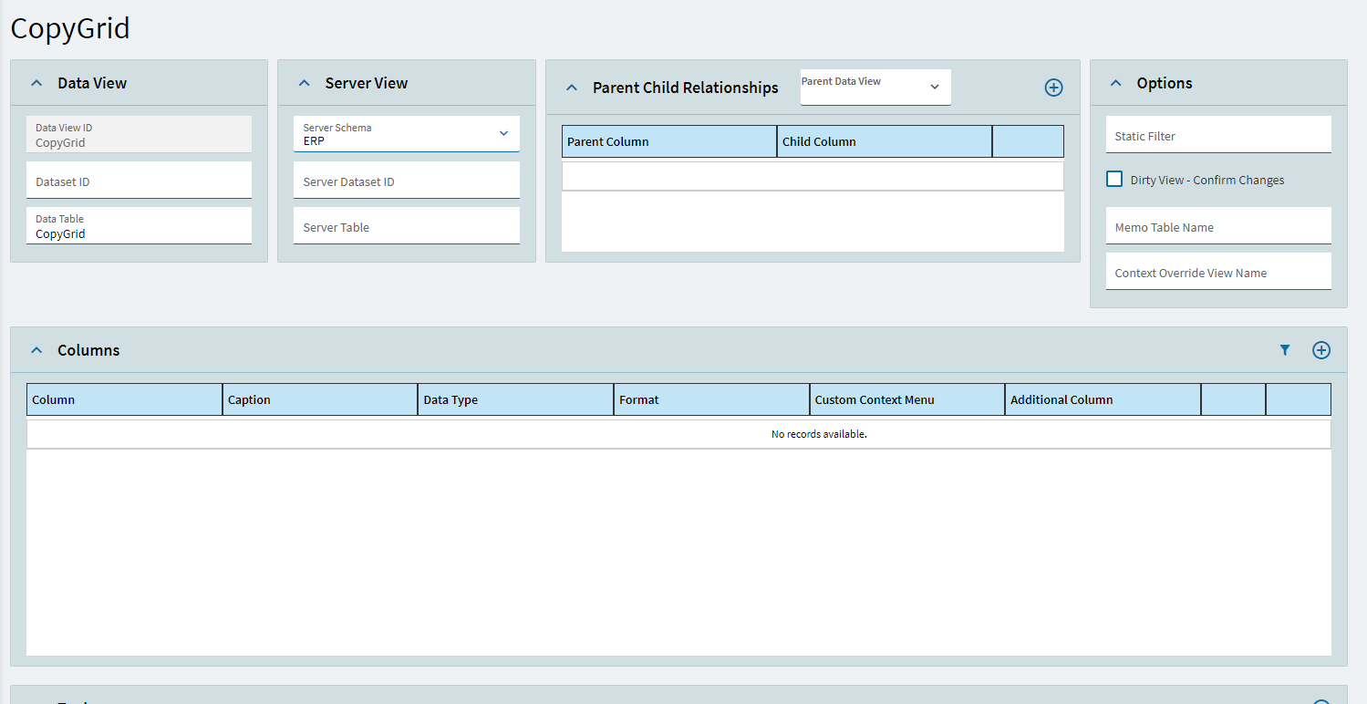

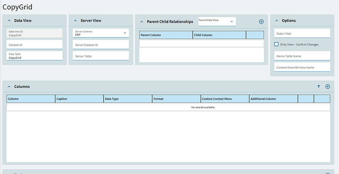

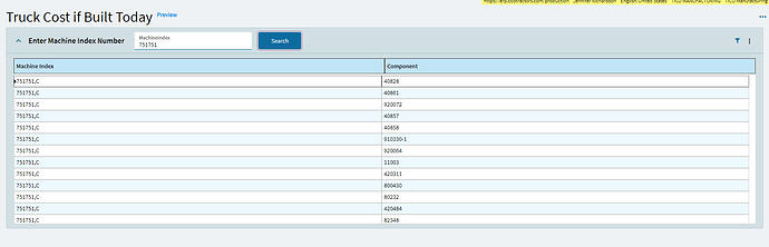

Thank you so much for your help! I created an event to copy the dataview and then bound it to my grid and got results
But when I try to define my columns under Grid Model, I don’t get data anymore:
Any idea why? I’m really only trying to rename my columns

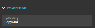

jrich2624
January 9, 2024, 9:05pm
12
Sure, I’m only referencing the same grid in both
hmwillett
(Hannah Willett)
January 9, 2024, 9:10pm
13

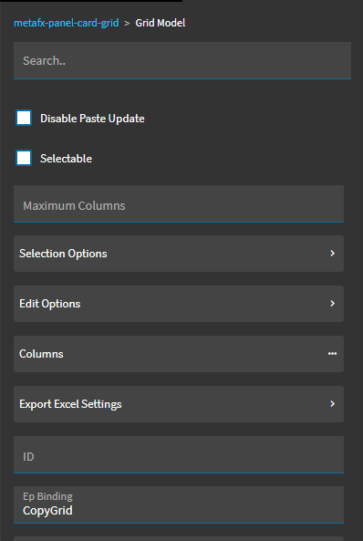

Would you send a screenshot of the Grid Model > Columns as well?

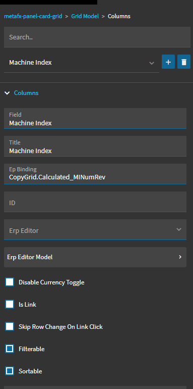

Sure, here is the first column:

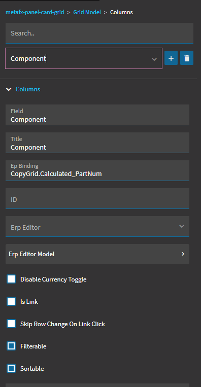

And here is the second:
hmwillett
(Hannah Willett)
January 10, 2024, 2:05pm
16
Remove the Ep Bindings and change the Field to be Calculated_MINumRev and Calculated_PartNum.
jrich2624
January 10, 2024, 2:12pm
18
It worked! Thank you so much!
