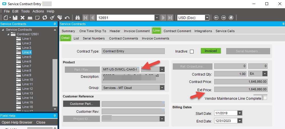

Hi @Banderson do you have an example about using row number by chance? I’m trying to do something similar you did get the max Extended price from all the lines and get which part belongs to that record to then link it to the part table and get some data from there.
