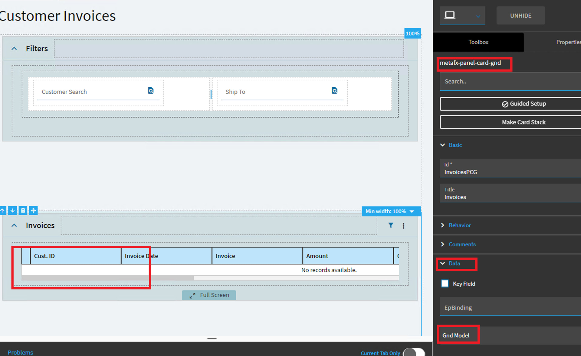

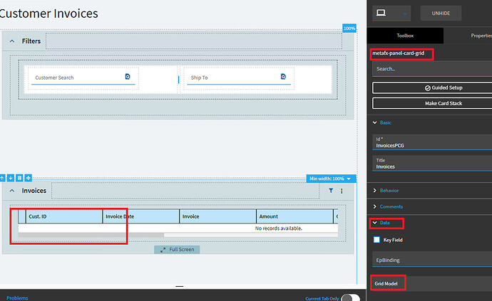

Being playing with this but I ground to a halt looking for “Navigate to metafx-panel-card-grid > Grid model”

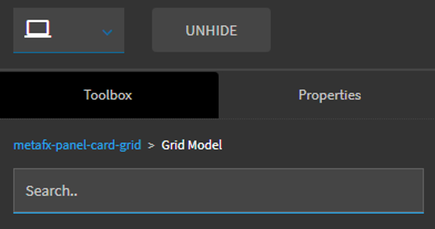

While your Panel Card Grid has focus, you should see metafx-panel-card-grid at the top. Then near the bottom, a Data link, and then a Grid Model button.
Then you should see this at the top right:

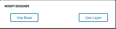

I am not sure of is “• Create a blank Layer” - how do I do this bit?
From the main Application Studio page (before opening any dashboard), There is a link that says Base. Then you get a popup asking if you want to Use Base or Use Layer. You want to pick the Use Layer option. I called it a blank layer, because you just create a layer this way, make up a name for the layer, and save it without actually making any changes to the layer.
