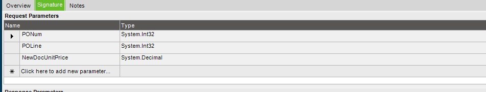

Thank you, have to admit I did not look , and should not have ‘assumed’ - how do you call the function and supply the necessary ‘input parameters’ , if this is possible?

Yep, below is one of the threads where there’s examples/discussion about passing in input parameters (using the Tuple input).
