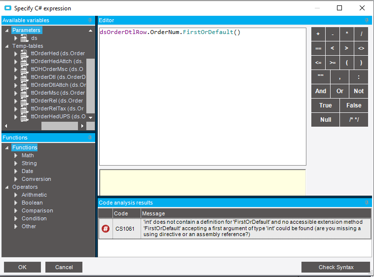

So I have tried to find it but there are multiple records in my message window but the number of the one I added exists. How to I get the max or highest number in what is returned? Below is my attempt
