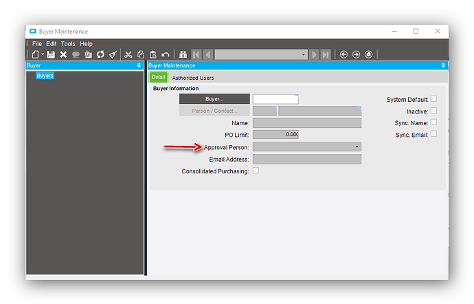

I am trying to change a user for PO approvals over a specific amount. I see under the Buyer Maintanance menu the option to change approvals for REQs.
Where would I change PO Approvers and amounts in Epicor 10?

Each buyer has can have another buyer set as their approver, and the approval amount
Thanks I think I found it. Just to make sure I have this right, example is below.
Under Buyers I the following listed
Purchaser
Purchase Approve
Finance Approve
Under Purchaser
We have list of all purchasers with PO limit set to $10000.00 and Approval Person set to Purchase Approve.
With this settings I interpret as Purchase Approve needs to approve anything over $10000, but anything under, the $10000 can be approved by Purchaser.
Under Purchase Approve
PO Limit is set to $25000.00 with Approval Person set as Finance Approve.
I interpret this as anything Over $10000 can be approved by Purchase Approve, but anything over $25000 has to be approved by Finance Approve.
Correct.
But each of the “BUYER”'s needs to have authorized users assigned. The folks who actually can act as Purchaser, Purchase Approve, or Finance Approve
Got it, have that set.
Thanks for pointing me in the right direction.
