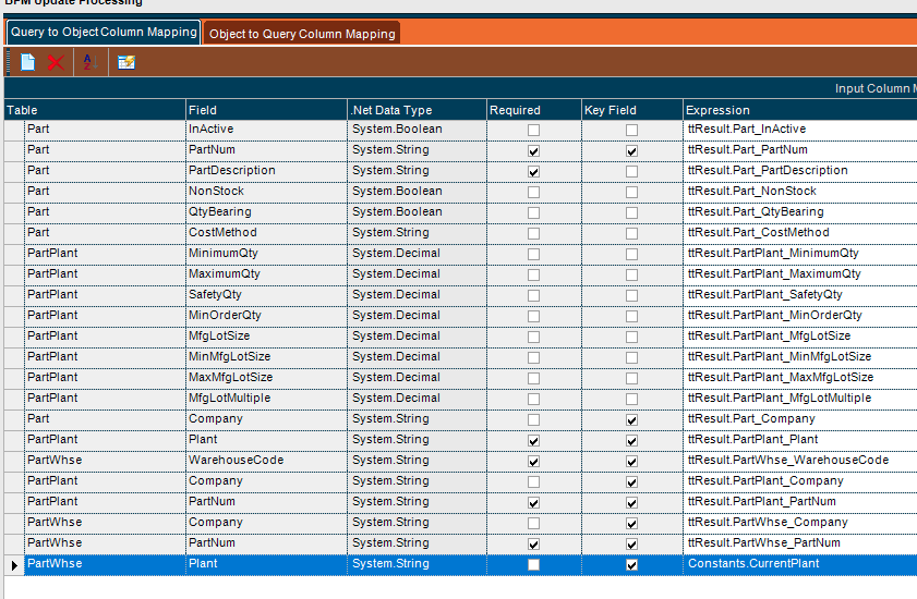

Here is my query to object column mapping

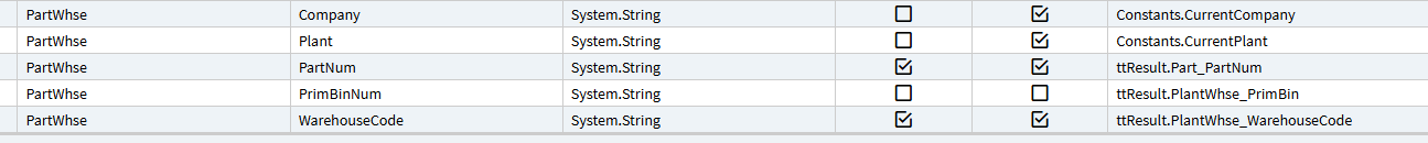

I was able to map the PartWhse.PrimBinNum to the PlantWhse.PrimBin and the update worked.
My query to object mapping
When I add the object to query mapping for this the line just disappears but the updates work. I’ve always thought that you needed mapping on both sides, query to object and object to query. But this seems to work. No syntax error and the field is updated.

In BPM Update Processing I used the Erp Part UpdateExt, checked Part. PartPlant, and PartWhse, then in Query to Object Column Mapping I manually added these lines:
