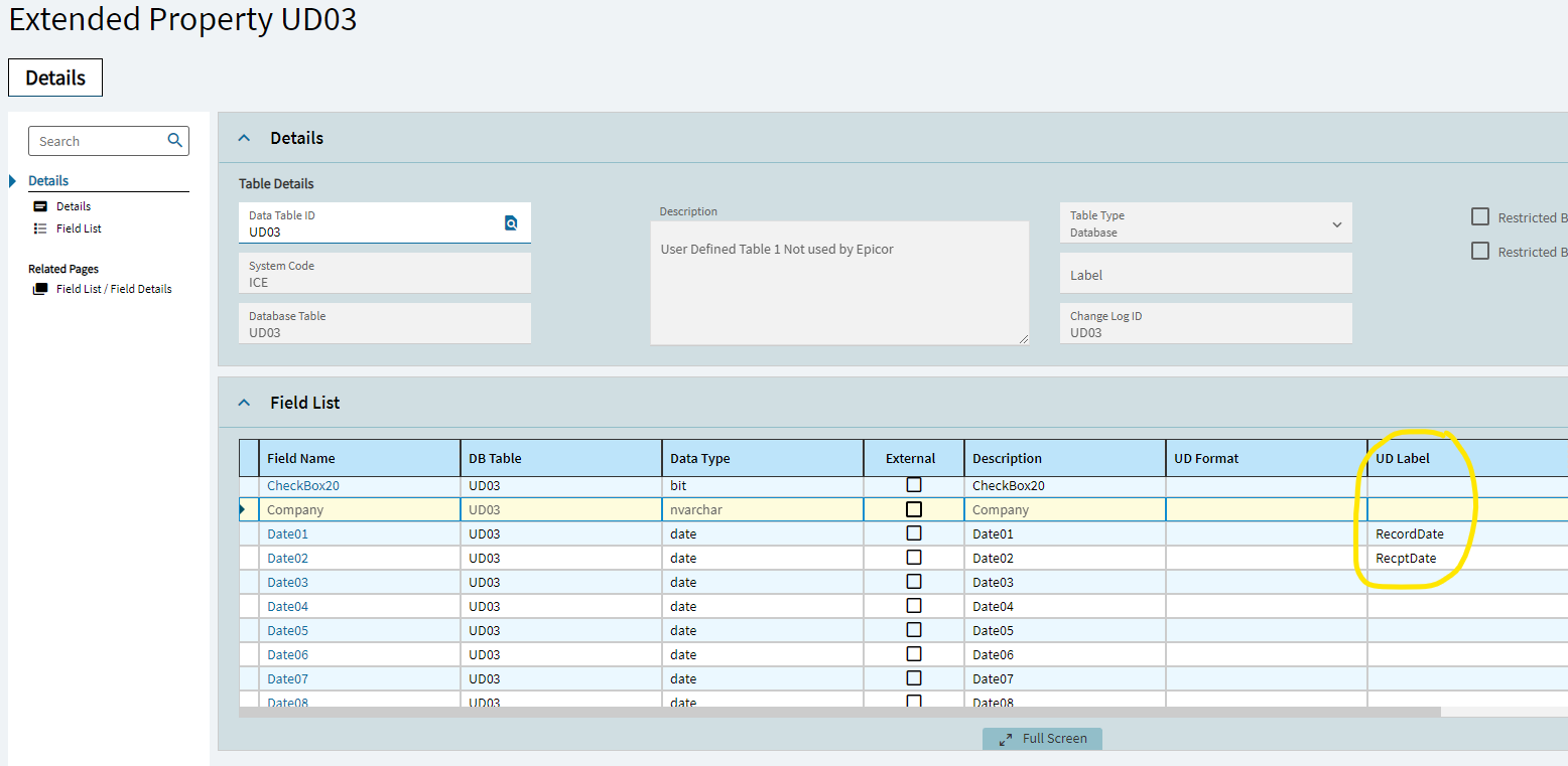

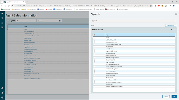

I have a custom UD form as seen below. I was able to eliminate all of the columns in the search results except key1. Now I want to change the label from “key1” to “Name”.
It must be simple but I cannot see it.
Please help!
Thank you, Richard
What’s driving the list of “names”? Is this from a UD table?

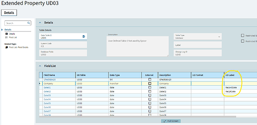

If so, you could try adding a UD Label in Extended Properties. Not sure if that would do it for you or not.
