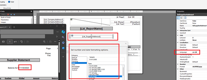

I am not an expert in SSRS. I have been trying to resolve this issue. Even though the fields are all the same datatype am still getting error and incorrect time difference in the filed in some fields. I do not know what am doing wrong. This is the code. Please find below screen shot also.
Code: =Fields!RptLiteralsLBalanceAsAt.Value & " " & FormatDateTime(First(Fields!InvoiceDateCutOff.Value, “RptParameter”), 2)

I changed it and it shows error.
Dates on reports are controlled by
Format Culture in User Account Maintenance
