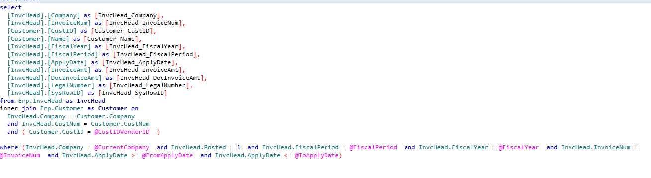

i want to compare the condition of paramater with a predefined value if that is true i will ignore the condition like i usually write in SQL what should it be
If I write SQL, I have a sentence like this:
declare @Posted int = null
select
[InvcHead].[Company] as [InvcHead_Company],
[InvcHead].[InvoiceNum] as [InvcHead_InvoiceNum],
[Customer].[CustID] as [Customer_CustID],
[Customer].[Name] as [Customer_Name],
[InvcHead].[FiscalYear] as [InvcHead_FiscalYear],
[InvcHead].[FiscalPeriod] as [InvcHead_FiscalPeriod],
[InvcHead].[ApplyDate] as [InvcHead_ApplyDate],
[InvcHead].[InvoiceAmt] as [InvcHead_InvoiceAmt],
[InvcHead].[DocInvoiceAmt] as [InvcHead_DocInvoiceAmt],
[InvcHead].[LegalNumber] as [InvcHead_LegalNumber],
[InvcHead].[SysRowID] as [InvcHead_SysRowID]
from Erp.InvcHead as InvcHead
inner join Erp.Customer as Customer on
InvcHead.Company = Customer.Company
and InvcHead.CustNum = Customer.CustNum
where (InvcHead.Posted = @Posted or @Posted is null)

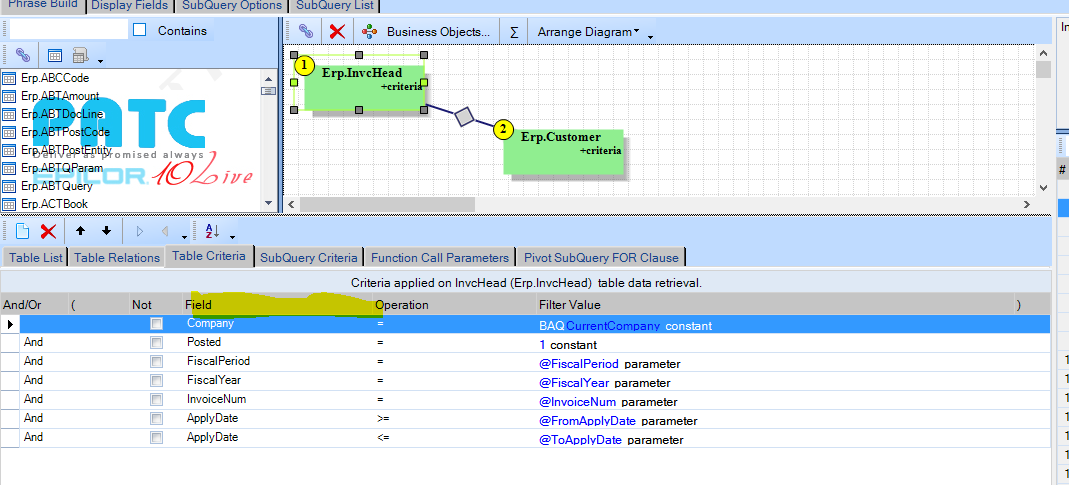

this is just an example, i want to ask how in the file column when designing the BAQ I can call the paramater there!

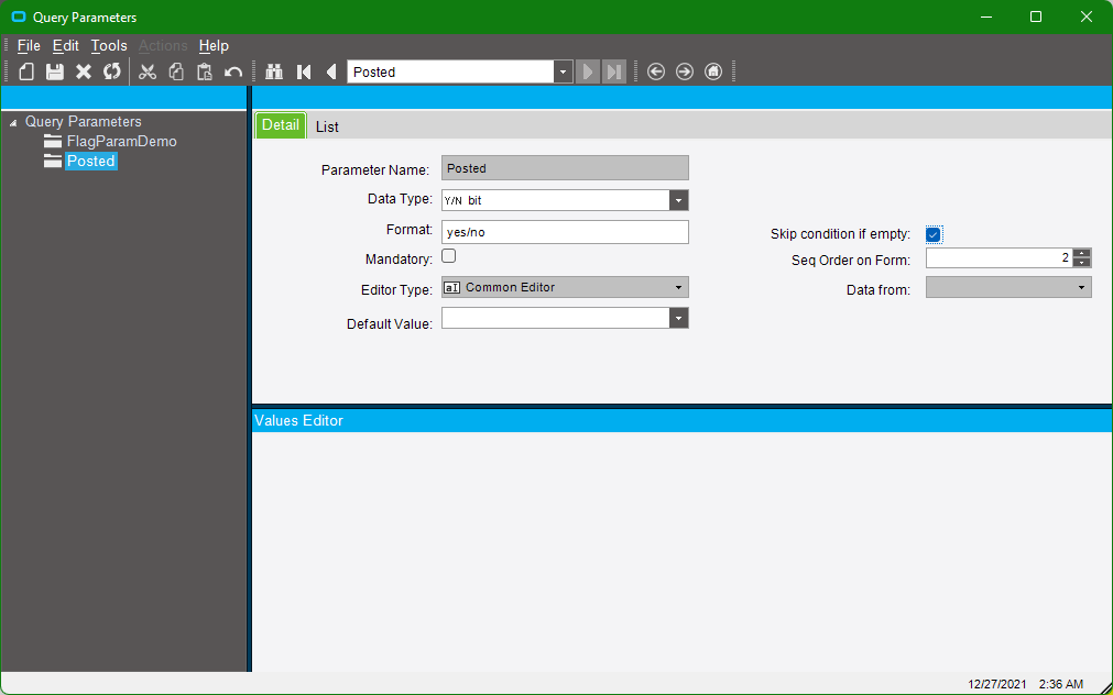

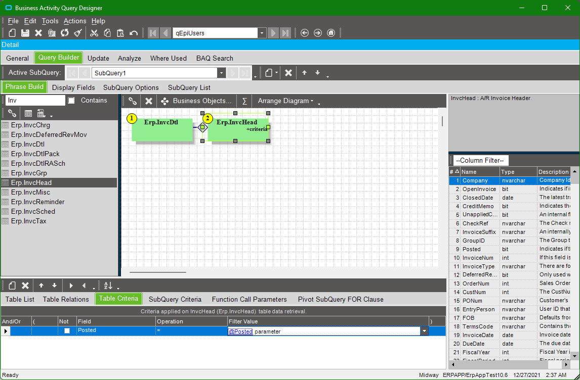

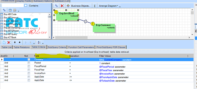

I’m pretty sure, but I believe if you check and uncheck that would give you your (2-NotPost), Checking it would be (1-Post) and not touching it at first run would leave it undefined and ignored (0-GetAll) as it will remove the simple condition where your parameter is being used.

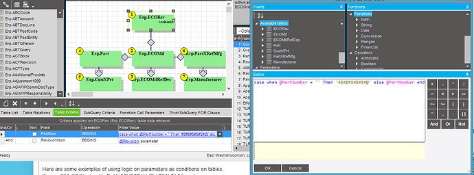

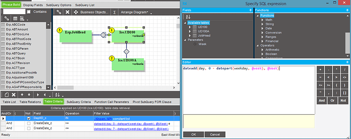

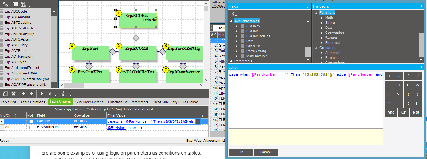

You want to use the criteria field, then use a comparison to an expression field. Here are some examples of using logic on parameters as conditions on tables. You would want to check if it’s equal to an expression, then do the case logic in that expression.
Edit* I believe he is asking to basically have a parameter that controls what is getting filtered based on what the parameter is set to. He could do a begins with expression then return an empty string if he doesn’t want the filter to be set. This way, sometimes a certain field can be filtered, sometimes another field can be filtered, sometimes both, etc. I’m sure there is some tricky way to do it with skip if empty, but honestly, some people are more comfortable with straight SQL logic.
This is what i need

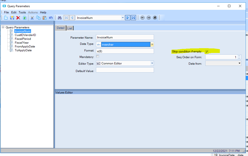

TL;DR : YES, you can with properly written criteria…
