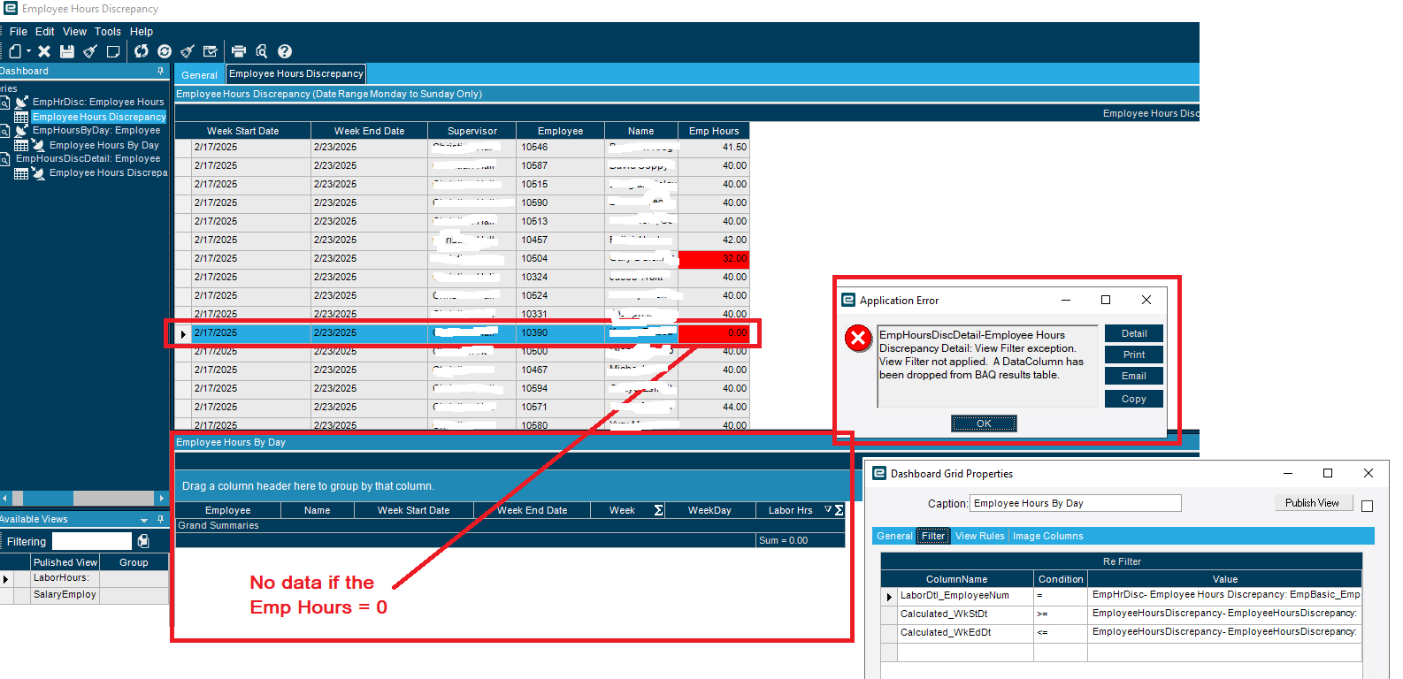

I have a two baq dashboard where the second baq is ranging on the some columns in the filter through the published column values from the top level baq.
In some of the cases where there is no range find in the second baq, it gives the Application Error e.g. “View Filter exception. View Filter not applied. A DataColumn has been dropped from BAQ results table.”

You said a “2 baq” dashboard, but it’s a 3 baq dashboard, and your second BAQ in the chain is the one that’s returning no rows and messing up retrieving info for the 3rd.

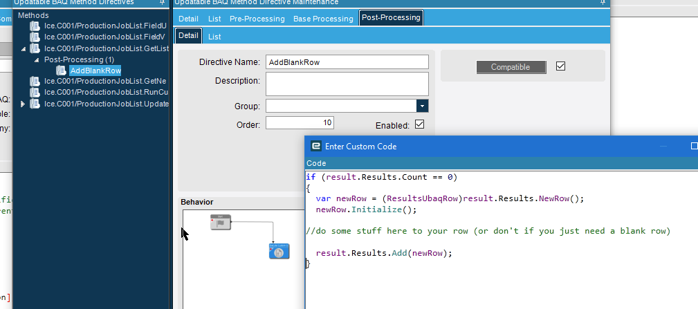

What I have done in cases like this is make second BAQ updateable, then if the results are null, add an “empty” row, or a default row so that the publish subscribe doesn’t break.

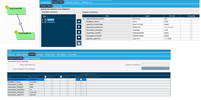

Brandon,
You are right. My dashboard is using three BAQ’s but I am still confused how to add blank row. I understand adding a blank row will solve my purpose but which table? This is a view only. Here is my BAQ Info:
You have to do some custom code as a post processing BPM on get list. Go to the help and look up updateable baq’s to see how you can add these BPM’s into your BAQs.
