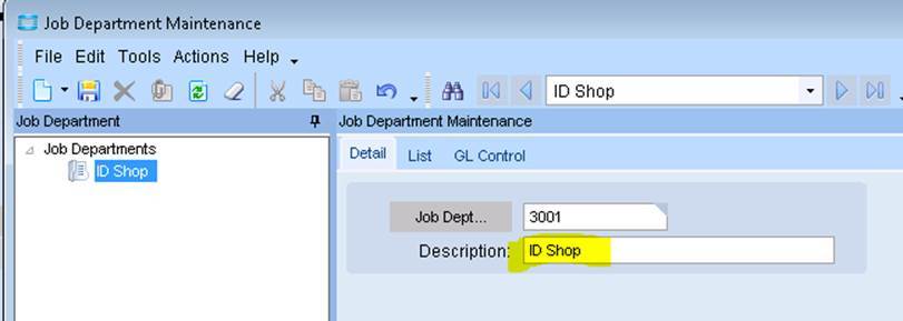

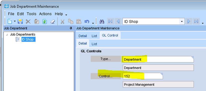

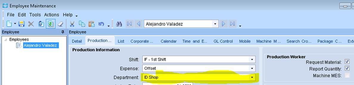

The Employee needs to be tied to a Department. The Department needs to be tied to a GL control code
Employee screen
[cid:image010.jpg@01D21B26.682D1D60]
Job Dept
[cid:image011.jpg@01D21B26.682D1D60]
GL Control on the Job Dept
[cid:image012.jpg@01D21B26.682D1D60]

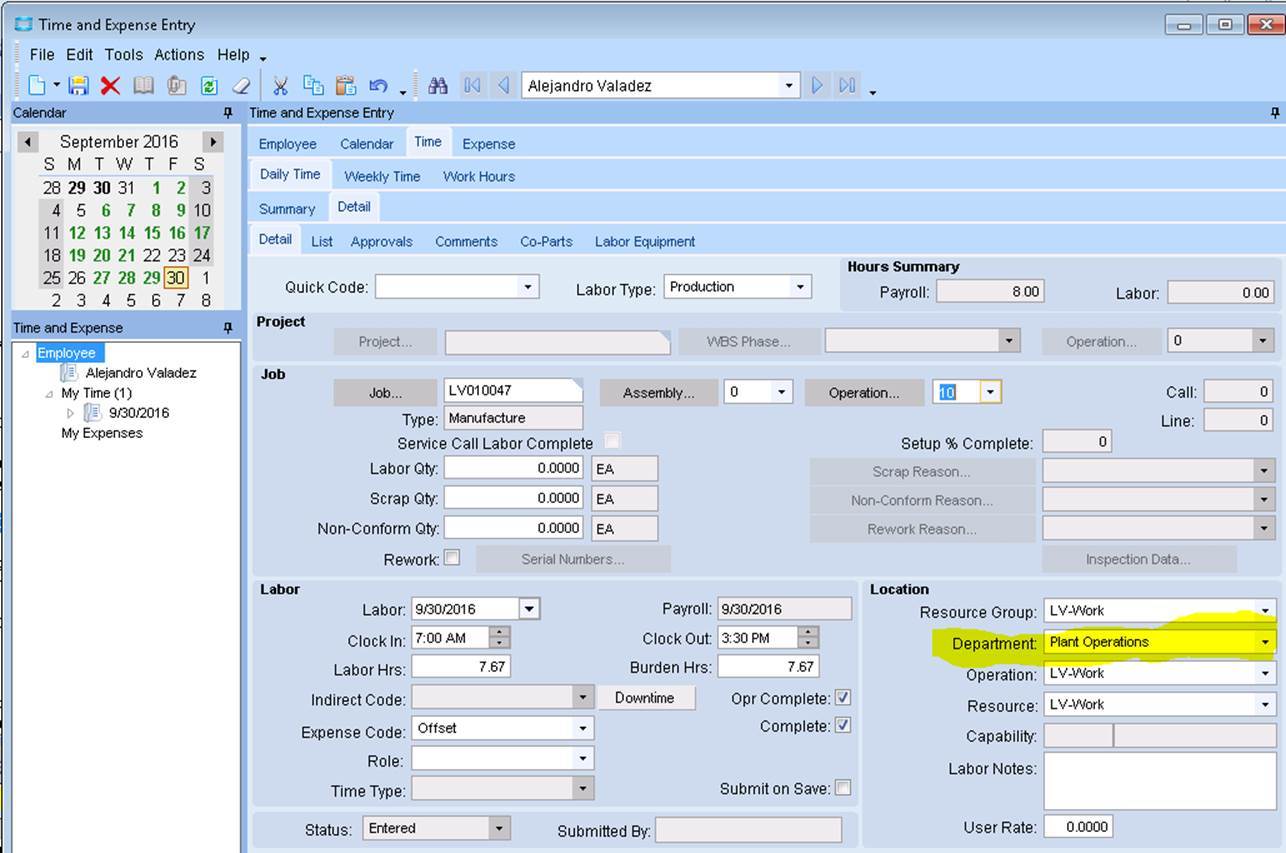

When time is entered, it captures the department. This defaults from the resource group. This is the department that will be used for the GL Control code.
[cid:image014.jpg@01D21B26.682D1D60]
If this is how it is setup, you should be fine.

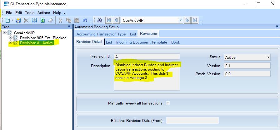

Let’s look at something else. Go to Finance/GL/Setup/GL Transaction Type
Select the COSAndWIP transaction type

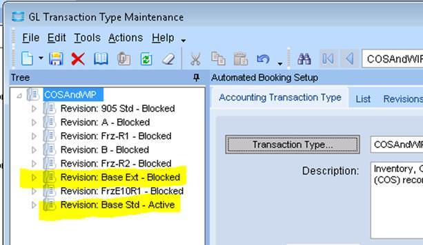

In the tree view, what revision is active?
You want “Base Std” which stands for Standard posting rules. “Base Ext” stands for Extended posting rules. You don’t want these – they are useless for most folks.
If you changed the revision name when you imported the posting rules, then I would suggest you reimport the Standard rules (provided you don’t have any custom posting rules) and try running the Inv/WIP report again

Andy, I think you’ve hit the nail on the head…We’ve only been on Epicor9 since February but the only posting rules that we have say 905Ext (see pic), we do not have anything that says “base”…
The A revision that is active is just an edit we made to disable posting indirect labor. How do I “re-import” the STD posting rules…

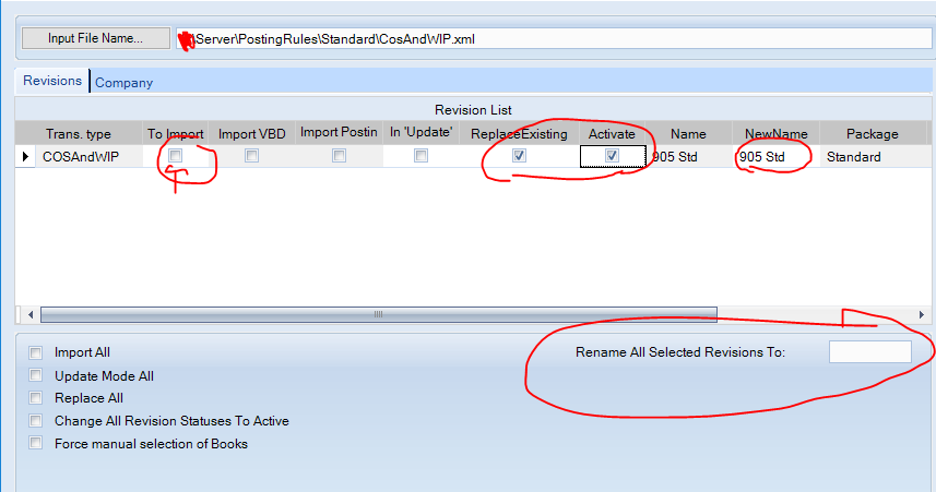

The extended should be fine, but to re-import standard go to actions -> Import ACT Type -> Navigate to you epicor server and the following file structure: Epicor -> Server -> Posting rules -> Standard -> COSWIP. Check the following boxes:
and click ok. That should import it and set revision A to Blocked and make the standard rules active.
To answer your earlier question, as Andy said the department will default in by Resource Group. I believe you can change the department so that it will go to the correct GL, we have it all automated right now so I can’t remember off the top of my head.
