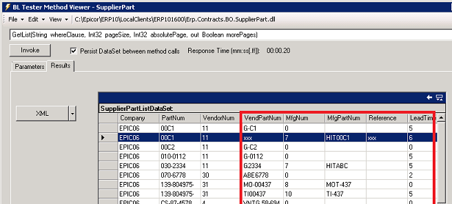

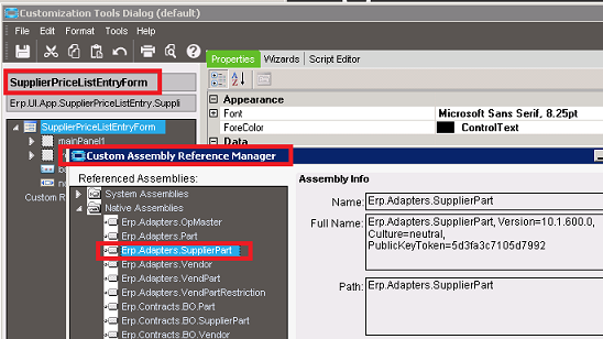

When I ran a trace looked like these are BO/methods that are involved?
BO: Erp.Proxy.BO.SupplierPart
Methods: GetNewSupplierPart
ChangeSupplierPartMfgNum
Update
Do you have the BL Tester setup?
I find it is helpful for deciphering the specifics of methods/parameters/datasets
