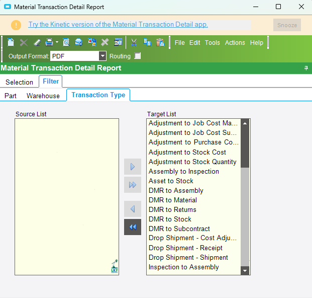

For example the “Material Transaction Details Report”, users need to filter by the same “Transaction Type” and fixed “Part No” every month to generate the report for the previous month.

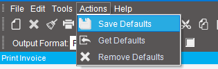

Does Actions/Save defaults work with that filter… It should.
Thanks Simon.
Yes. I just tested the save and get defaults and it works perfectly well.
Just that users has more than 1 set of filters to pull the report regularly, the Save default can only save 1 set filter.
Any idea if Epicor can save more than 1 set?

Interestingly was testing this on the Inventory Rec report on 2024.1 and the transaction types parameters would not stick in classic form but would in the Kinetic form.

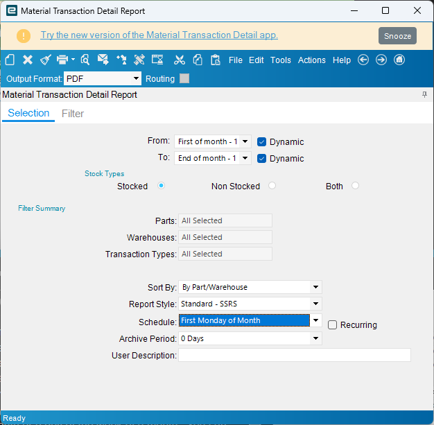

If this is a report that is run on a regular basis i.e. the user runs the report on a monthly basis at a particular time every month and they do it manually. Then I would suggest you could schedule the report and have it emailed to them, or print preview, with the parameters set for each instance of the report to run. You could also use the Dynamic dates of From - First day of month - 1 month and To - Last day of month -1. Then apply it to a schedule of either a specific day of the month or a day of the week of a month. You can look at the capabilities of the System Agent and using Dynamic Dates in the help.

@gohhy as mentioned in my last post, really the only option is to schedule the report multiple times with different parameters.

At this point I am going to ask you to check the online help for “Dynamic Date Options” and “System Agent Maintenance” I would also do search for “Process Set”
This should provide you with the information to create multiple scheduled instance of the report with different parameters.
