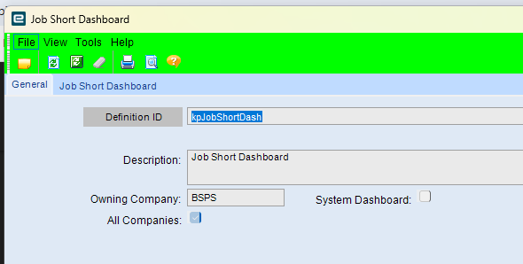

How to default active tab in dashboard

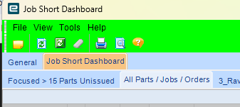

Do you know how I can force the first tab to be the active tab when opening the dashboard? I watched it open and it looked like the tab with the most data loaded last then became active. I turned off Auto Refresh on Open but did not change anything.
I would like the first tab to be active when opening.

Try rearranging the tabs a few times.
Always has been buggy and inconsistent.
That sort of worked. Moved the 3rd tab to 2nd, now the 2nd tab still opens. I’ll just put my favorite tab there for now lol.

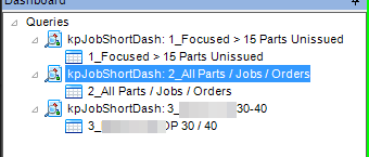

3 queries. I think its just making the longest query active.
They could probably be 1 query with different views. I;ll try that.
Ok so when its individual query it makes the slowest query and grid view active.
When its one query and different views it works fine.
And probably best practice - sometimes cant use the same query but i got sloppy and it caught up to me.
