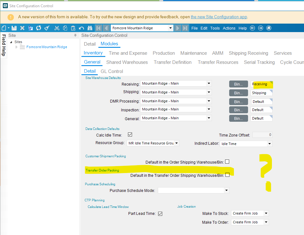

When receiving a transfer order, it defaults to the default bin we set up in site configuration. How do we get it to default to the primary bin from the part/site record?
The “help” information on the site configuration doesn’t make it look like I can set it to the primary bin.

When you process Receipts. They default to the Warehouse/Bin you have highlighted in Site Configuration and then Epicor can queue up a Put Away transaction for those received goods to go to the controlled warehouse or inspection as needed.

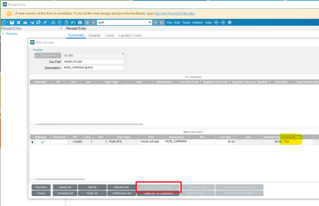

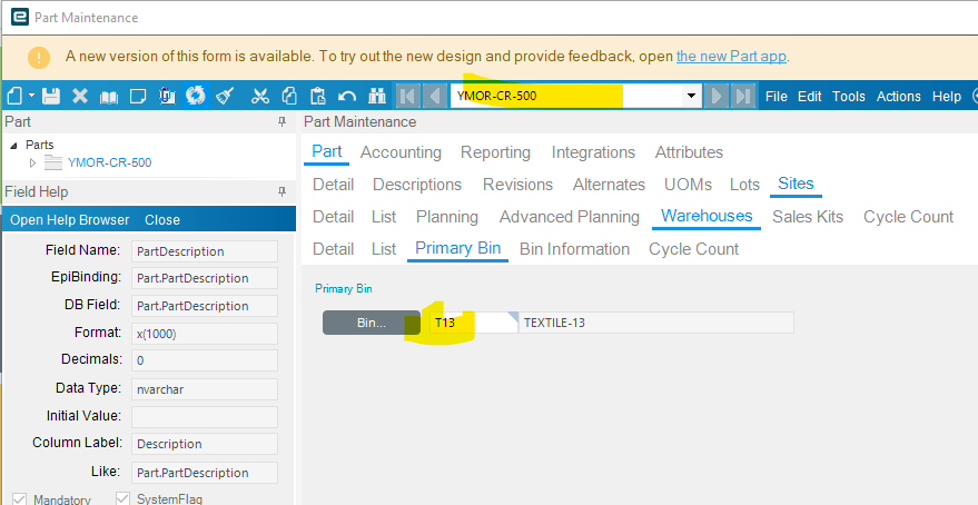

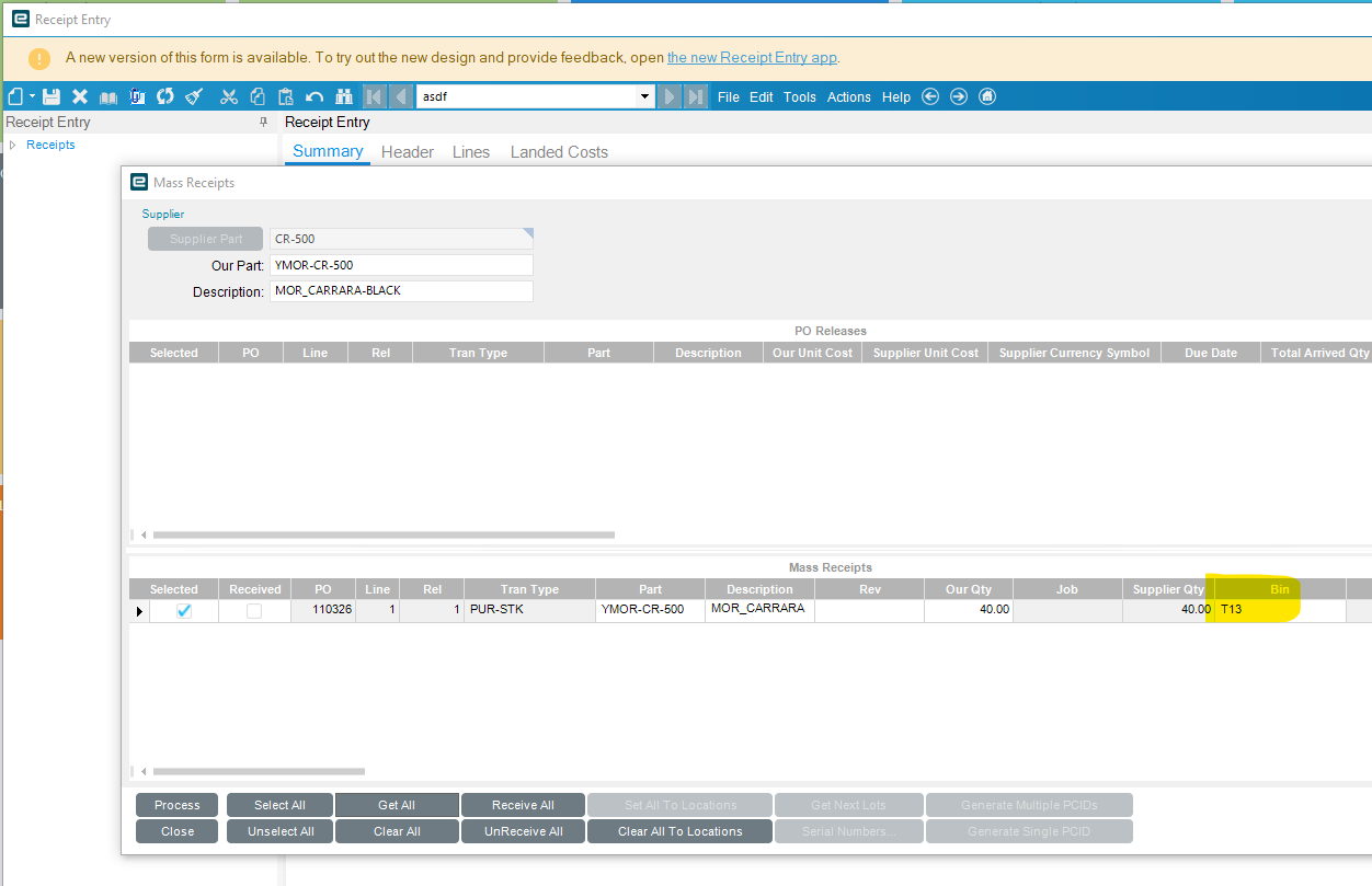

However, you can skip this process all together by using the To Location in Receipt Entry or Set All To Location in Mass Receipts and Epicor will fill in the Primary Warehouse/Bin combination for you.
Edit: Screenshot for clarification
I think this is currently disabled in your screenshot because you manually selected a location. Is it enabled if you don’t fill that in? Not sure if AMM is required for that functionality to work or not.

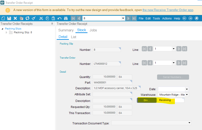

Chad, you seem to be referencing Receipt Entry, and I have the issue with Transfer Order Receipts. There is not the same functionality in TO Receipts, as far as I can see. I am trying to get the receipts to default into the Primary Bin for the parts, instead of one singular default bin for TO receipts. Any insight?

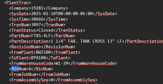

Hi Alicia;
Would you be willing to share a bit of your BPM logic? I want to create the BPM so that if the Txfr order is received in a specific site it will update the bin to the primary in that site when Receive all is used on the Transfer order Receipt. In the Trace the first reference i find of the Bin, is in I was looking for a method that referenced “ReceiveAll” but didn’t find anything.
