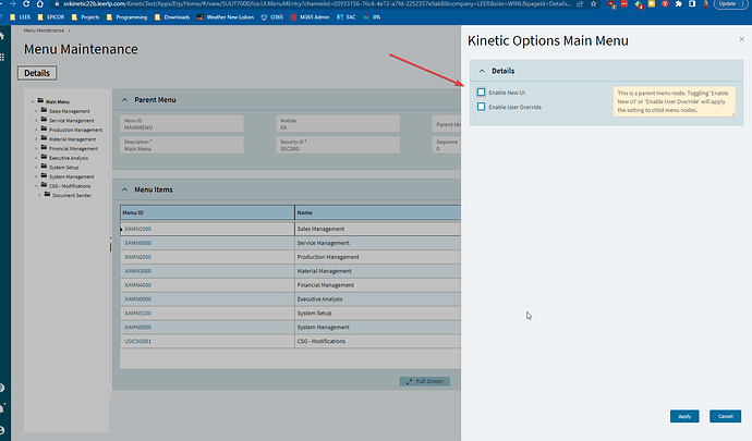

So, now that they have removed Kinetic Application Maintenance in 2022.2, has anyone worked out what the best method is for completely shutting off Kinetic UI screens for now, while still leaving the option there to, in the future, start transitioning them to “user choice” or Kinetic UI on a per-department (or group of menus, or maybe group of users). I looked at the new Kinetic version of Menu Maintenance, but it seems that no matter what menu I look at, if I go to three dot menu and Kinetic Options, the “Enable New UI” and “Enable User Choice” options are ALWAYS unchecked. I even tried checking them a bunch of places to see if setting it and then unsetting it would work, but as soon as I refresh or reload, they are unchecked anyhow, like it’s just completely broken.

If the functionality in your screenshot is the same as how it was in kinetic application maintenance, then I would expect if you toggle enable new ui on, then save, then toggle it off, then save again, that it would disable kinetic across the board.
I thought that might work too @aosemwengie1, but it seems whatever those checkboxes are I either completely don’t understand them or they are broken in 2022.2.5
If I open Main Menu, then goto … > Kinetic Options, then check the checkbox, hit apply, then hit save and immediately without even reloading go back to … > Kinetic Options, everything is unchecked again… doesn’t seem to matter how I try, it’s like the checkboxes aren’t actually hooked up to anything in the application or database.

I figured out by looking at the Menu records in the database that the new Menu Maintenance (Kinetic UI) screenshots I’m showing above are changing the Ice.Menu.DefaultFormType to “Base” on all the menu/submenus in the database. I’m curious, do you know what the -KineticUI argument does, if that is still there? Could it be that is what is causing this to display?
