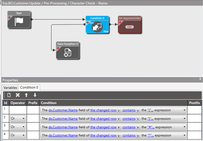

At the moment I have made the following condition below:

The first condition successfully raises an exception when those values are input by the user, however I want to include numeric values to and due to my lack of knowledge of Epicor I don’t know how to set a variable to type RegEx as it doesn’t give you the option to do so (or not that I know of) and pass that through in the BPM.

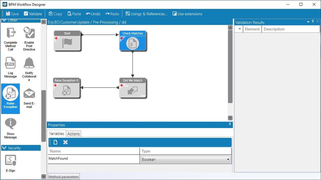

Create a variable:

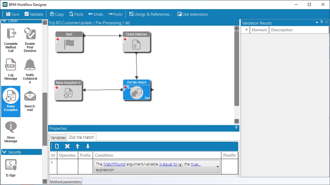

Check your variable:
Do something with it:

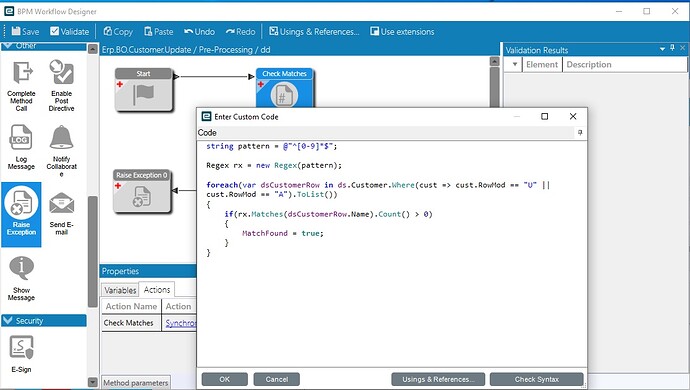

Some starter code:
//Check Matches Section
//This is just meant to be a starting point or framework...
  string pattern = @"^[0-9]*$";
  Regex rx = new Regex(pattern);
  foreach(var dsCustomerRow in ds.Customer.Where(cust => cust.RowMod == "U" || cust.RowMod == "A").ToList())
      if(rx.Matches(dsCustomerRow.Name).Count() > 0)
          MatchFound = true; //This Variable is set in the Widgets!!!
