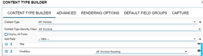

You need to add workflow to the content type and assign it the workflow name that you would like the content type to be assigned to.
I think that’s how to do it off the top of my head.

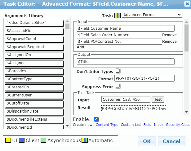

You assign a workflow to the content-type via the “Content Type Builder” and it should run through the workflow anytime that content-type is imported. I’m pretty sure that includes documents imported via Epicor (since you assign a content type to these as well anyway). Then you can OCR the data you want, and use some other “Tasks” to form the document name. Then you can use a “Advanced Format” task to set the title to whatever you need. We’re on an older version of DocStar, but here’s an example of setting a title. One of the “$Field”'s could be something you OCR.
