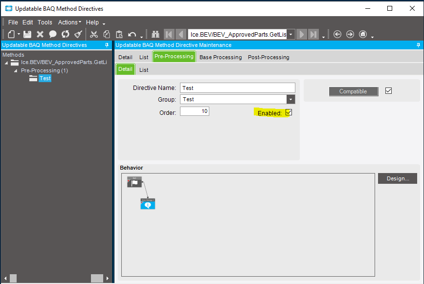

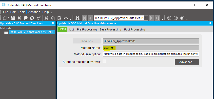

just test to prove the concept, attaching code at UBAQ GetList built in method triggered when clicking Get List within then BAQ designer, nothing happened when the export run, am i missing something here ?

yes

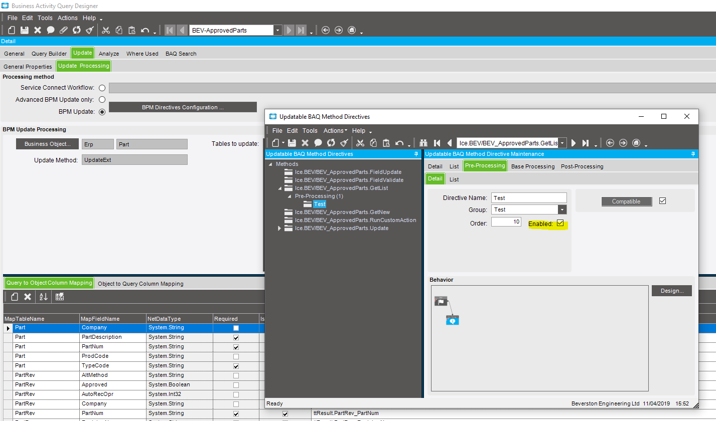

This needs to be done form the BAQ I’m not sure how / where you are but this doesn’t look correct.
same thing it just another UI will take user directly to the UBAQ BPM configuration
here from the BAQ designer UI
That should work. It does in my system. I have no idea what you’ve got wrong.

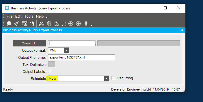

does it make any different if i submit the export Now instead of submitting it to the task agent ?

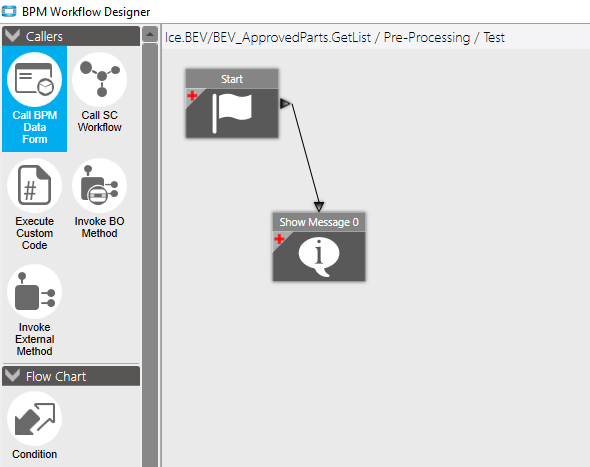

Message boxes aren’t going to show up in a server process. Who is supposed to see them?
i am just trying to prove the concept, i will try sending an email and see

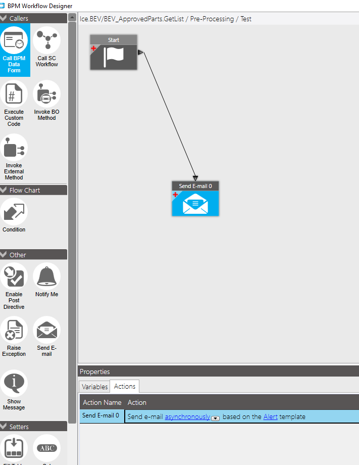

i have change it to sending email both ways asynchronously & synchronously, still no lock, i must have missed somthing

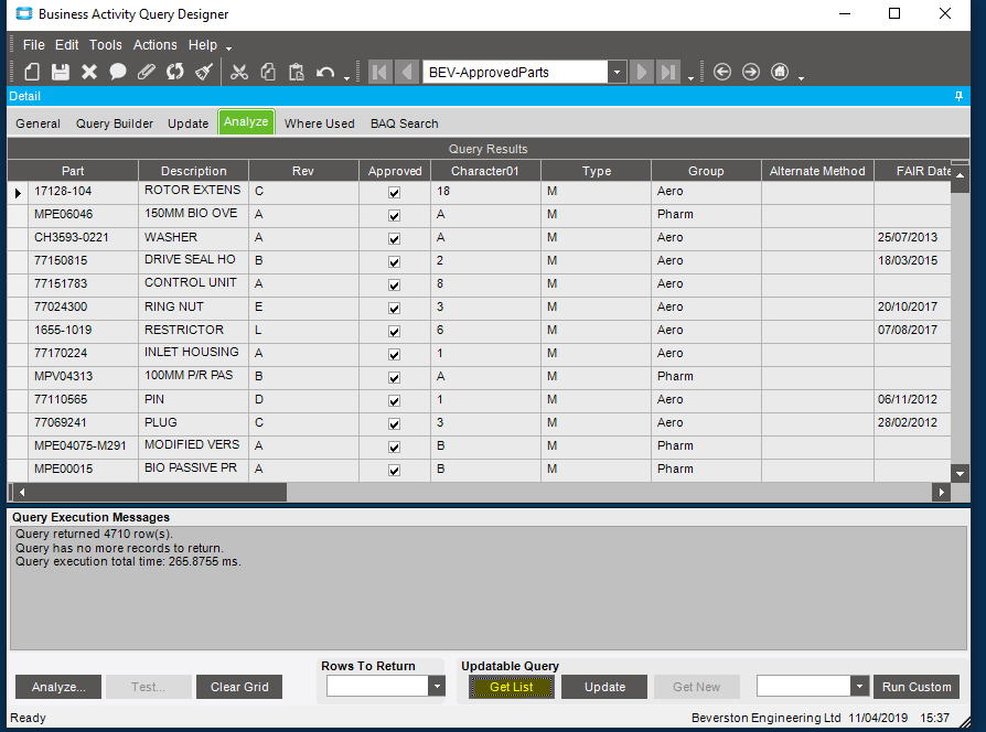

Did you ever get this working. I’m having the same issue as you were. The GetList BPM fires only when I run Get List from the BAQ designer. But when I run the BAQ Export Process, no luck.
i have ended up using process schedule to trigger any BPM code i want
