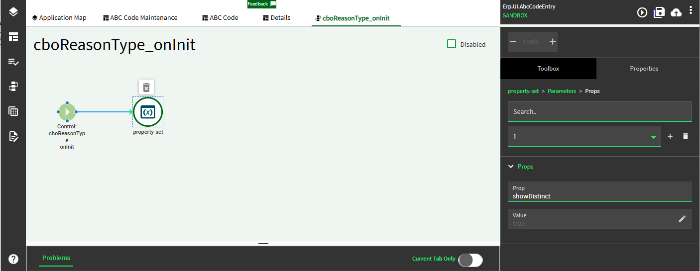

There is a hidden property of ComboBox component called showDistinct. If you create an event onInit you can property-set action to true.
This should be a checkbox in the AppStudio designer combo properties but its not - maybe only in configurator designer.
Brilliant! That worked! Thank you! Now I just need to figure out how to sort the list.

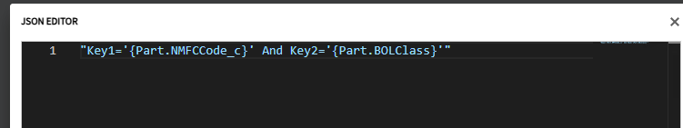

For those using two dataview fields to filter, here is an example of that which worked. You have to add the columns to hidden columns. I had to add the second to append hidden columns because it was adding a space in the column of the second in the primary hidden column property field even though there wasn’t one.
