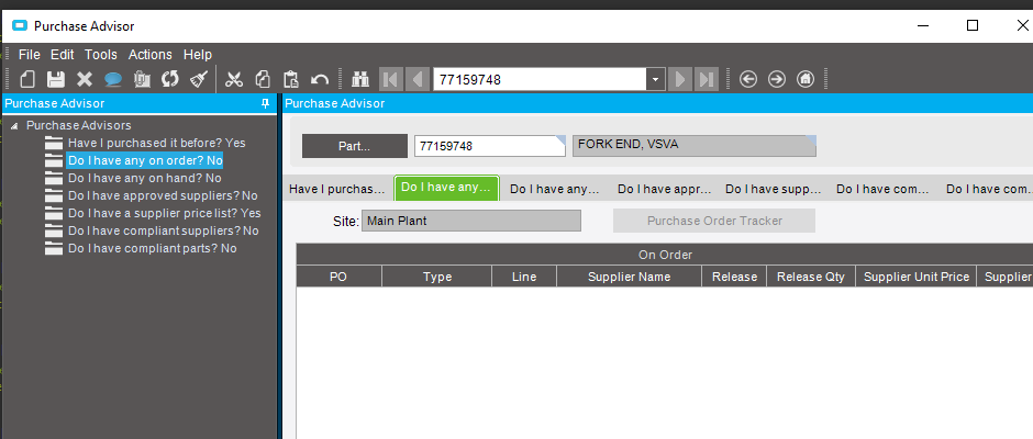

I have written a dashboard that lists all parts with an assortment of details on each part. One of the requests is “Total Demand Qty”, “Qty On Hand” and “Qty On Order”. I have found the first two, but where do I find the “Qty On Order”? Is there a database field somewhere or is it calculated from purchase orders? If it is calculated from purchase orders, how do I find them. If I limit my search to open purchase orders, what about lines that have been received. When does an item move to quantity on hand, as soon as it is received or after it is received and the PO closed?
QOH is incremented upon receipt (actually marking the pack slip “received”. Marking it just “arrived”, won’t show as QOH).
If the received complete setting on a PO receipt entry is what drives the PO’s release and line to be marked closed.
Take a look at the PartDtl table. It’s basically timephase without the onhand qty. You will need a group by and some calculated fields, but all the demand and supply will be there.
as @Carson mentioned, if it is not on PartDtl, then create a subquery on PO and sum all Open PO lines/releases not yet received and link it to your top level query, also this information and much more already exist in the Purchase Advisor view screen
